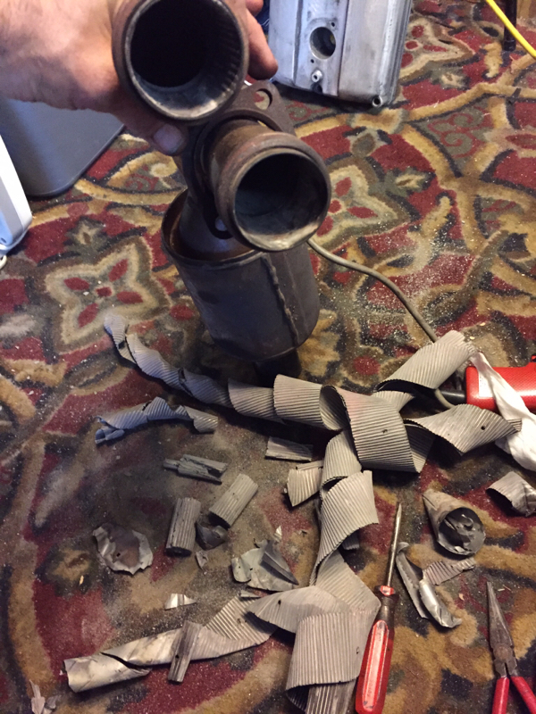

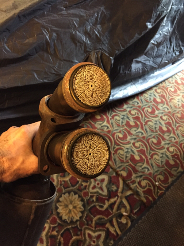

I have gutted cats on my 86, not hard to do, sounds fine ( also removed the mid mufflers) big issue is the blockage at the top of the down pipes, I'n removing that I got to where I can have the down pipes down on a V-12 in 30 mins (first time not so much)

The A bank is RH side of the car. If yours is a LHD car the drivers side is the B bank. You need to make sure the A bank is firing on all cylinders.
DO NOT GUT THE CATS, unless they are the ones inside the down pipes. Doing so will hurt flow.
If the exhaust system is still in good condition then I would replace the Cats with high flow units, this will keep the car legal and in a road car not effect power very much.
The down pipes are very restrictive and I have heard from numerous V12 engine builders that where the pipes are joined there is more often than not intrusions of one pipe into the flow region.

You'll need to pull the steering rack heat shields (super easy) spray some PB Blaster liberally on the nuts and just use some extensions and deep well sockets, really not hard to do. I put all four of my tires up on ramps and jacked up the front even more to allow comfortable room. Sprayed them down and waited till the following morning. Jaguar uses a steel, long nut with a brass locking insert so corrosions not usually an issue unless someone's been there before and improperly replaced them.
