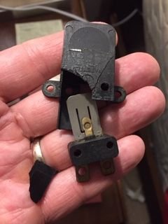

The sensor/switch shown below was attached to the right side (US/left hand drive) air intake box. It appears to me to be a sensor/switch (probably air temperature?) but I thought the air temperature sensor was on the left side intake. In any case, I don't know what this is, but I *clearly* will need a replacement (new/NOS/used).
So, what am I looking for? Anyone have a part number?
Thanks!!

yes, air temp sensor, part number DAC5061. Item#17 in this illustration. It for the Marelli Ignition ECU as far as I know
https://parts.jaguarlandroverclassic.../brand/jaguar/
The air temp sensor in the LH air inlet snorkel is fr the fuel injection ECU

Hey!!!!! I need one of those too. Mine looks just like that.
