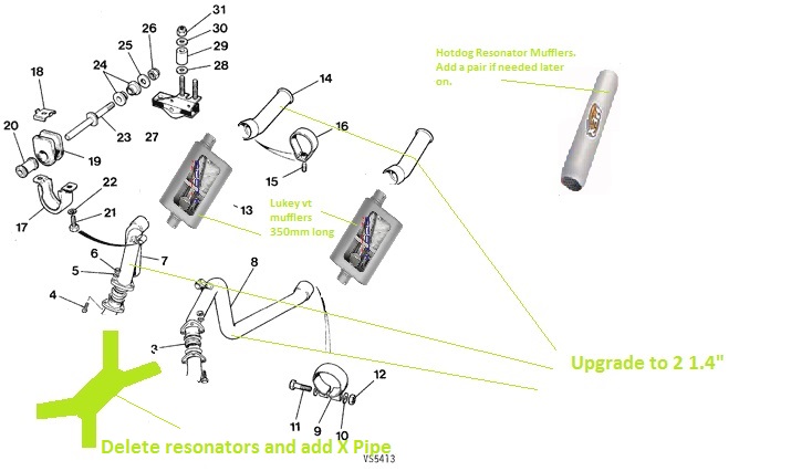

Ok, well in the spirit of the Thread's title, here is my plan for upgrading my exhaust to hopefully get a "Euro growl".
Many thanks to a good mate (fellow forum member) for helping me come up with the plans.
Now...just gotta save up the funds and make moves towards getting her sorted.
(I only hope the exploded view of the exhaust is pretty much what I got under my bonnet as currently I am on the other side of the continent working at sea)
Attached Thumbnails Upgrading Exhaust to get more growl-intermediate-rear.png   Upgrading Exhaust to get more growl-take-2.jpg

Not sure that will do it Pauly.
I am running 2.25" on my 6 litre back to original straight through rear resonators. No mufflers and with windows up no noise at highway speed unless l plant the foot. If you are replacing those straight through resonators with mufflers l would assume it will be less not more.
May l ask the reason for X pipe on V12?

Hi Baxer
I am still but a learner so my honest answer is I am not entirely sure yet, however my friend who help me come up with this plan has just upgraded his XJR and it sounds fantastic, so I have faith
Still, our plans were done back and forth on the web so I may of got something mixed up in translation. In saying that, if there are any errors it will be from me, not my mate lol!
On mufflers and Resonators, Jaguar Heritage website just calls them silencers, but from my understanding, the rear ones are mufflers and the intermediate ones are resonators. Can anybody confirm? Have I got it a** about face?
From what I have learn't Resonators cut the high tones Mufflers lower the volume
The plan is to to leave the front section as is, then, attacking the intermediate and rear section as below, to the best of my understanding:
1) Delete items 1 and 2 (intermidiate resonators) and replace with X pipe:
Exhaust gas is pushed out harder as the engine spins faster. The X-Pipe pushes out the exhaust gases into two uniform streams, allowing a smooth flow from engine to tailpipe. Both streams keep each other up to speed, which draws even more spent exhaust out the cylinders. Will help to provide a boost in horsepower and a higher tone. More noticeably at higher RPMs.
As I understand it: X-Pipe = exotic car tone vs H-Pipe = muscle car tone
2) Run straight pipe to the rear mufflers and swap out the stock rear mufflers (item 13) with Lukey Vt(valve technology) sports mufflers.
3) Upgrade the pipes from stock to 2 1.4 in. The calculation my mate did based on the size of my engine and a bit of mathematical wizardry.
He told me once its on I may need small 300-400mm long resonators to cut any raspy sound so we are going to see how it goes.
I am aiming for a Euro Growl but definitely nothing like a muscle car.
Be patient....I am a beginner and encourage any feedback.
cheers
p.s We have been coming at it on the view point of two separate engines. One either side. 6 cylinders each side if that makes sense.

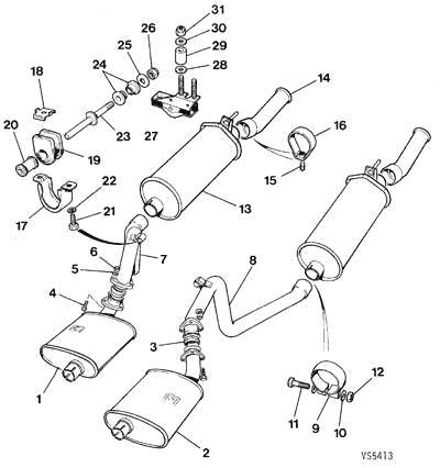

The bigger items under the middle of the car are Silencers (aka by USA English as mufflers). The rearmost items in the tunnels each side of the boot are resonators. So A about F it is in your post!
In the UK they are all called silencers, resonators also being called "straight through" silencers. Subject to correction by experts, I think I remember from the very good book published by Roger Bywater (Engine Technology for the modern world, which I highly recommend as it is really informative and written for the interested layman) resonators remove certain sound frequencies and the bigger ones certain others. It is a matter of which design removed which frequencies best.
It all comes down to how much noise you can stand! If the middle silencers are removed then the noise will be substantially increased, I have heard an XJS with this done and it was basically deafening. I am NOT saying this is the case for all cars so treated, but it was for the one I actually heard accelerating away when I was standing outside it. If the rearmost ones are removed then drone results as those frequencies are unsilenced. There is no substitute for trying a few combinations and deciding what you like best, which is fun but potentially expensive.
I am pretty sure (again from the above book) that a cross pipe of whatever sort may change the tone of the exhaust; but will do nothing for power or efficiency, and may even make it a bit worse as the resonance required to generate the sonic waves that aid cylinder emptying on the exhaust stroke may be made less effective, depending upon where the cross pipes are placed.

Cheers Greg. You are certainly a wealth of knowledge my friend
So would this be correct now?:
Attached Thumbnails Upgrading Exhaust to get more growl-mufflersandresonators.jpg
