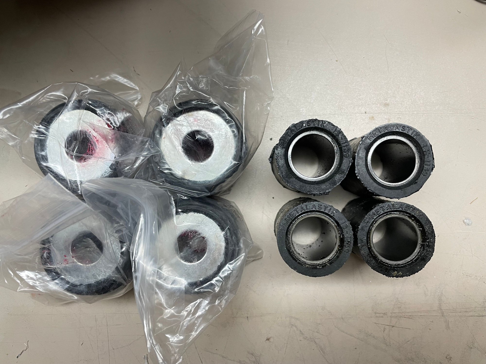

Hey everyone. The parts acquisition phase of my IFS rebuild is nearly complete and I should be getting all the bits back from the powdercoater and electroplaters very soon.
I ordered these from SNG Barrat as they were the only option. I had crossed my fingers and toes that they'd end up being Metalastik bushings as I've read on the forum repeatedly that everything else is rubbish, but alas, they are URO brand. I've searched high and low on the web for Metalastik bushings and have come up empty. I also tried the local Jag dealer but according to their parts dept. they are obsolete.
I've seen Metalastik bushings for sale in just the past few years and in fact the body "V" mounts I also ordered from SNG are branded Metalastik; so have they just recently become NLA? And if so does anyone have experience with URO branded bushes? They're made in Germany which seems like a good sign.
But if someone has a source on Metalastik upper & lower control arm bushings I'll gladly chuck these in the spares bin and order another set..

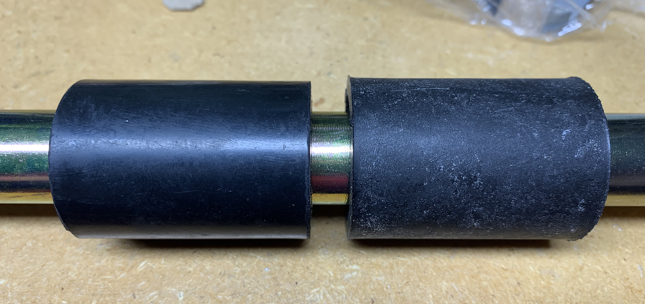

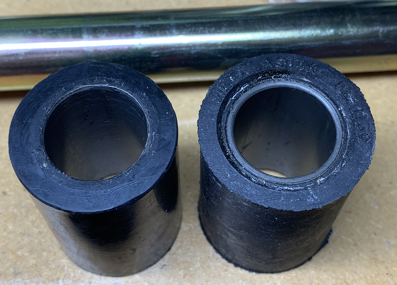

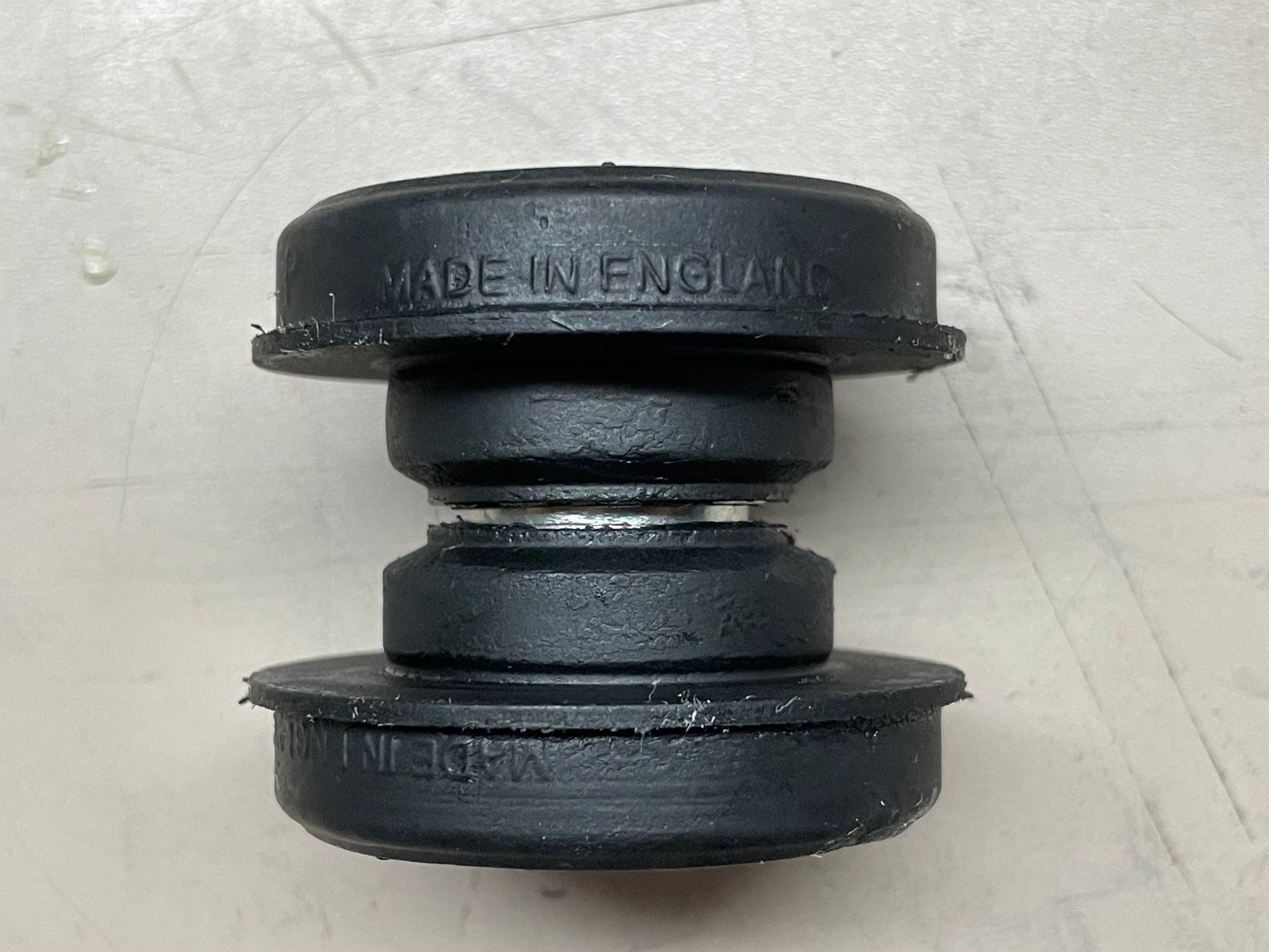

Jack is one of those few prepared to go the extra mile, I have encountered the same in Ben at Simply Performance, with Ben he generally offers options and understands that not everyone is into 'OEM' style prices, it helps to know your options ahead of time. Manners and Simply are my go to's - I also use SG Barratt occasionally - they do not stipulate the parts source so you need to ask.
I bought my Metalastik from Simply a year ago and they didn't indicate any issues getting hold of them - I re-ordered a full set after receiving a 'rebuild kit' from a place I won't name (to avoid repurcussions) which absolutely is not OEM, it is in its box where it will stay - lesson learned. Bought with enthusiastic impulse before reading all the horror stories and they're out there trust me - failure within 2000 miles. That isn't to say that the bush was all to blame though - but I'm taking no chances - it is clear from some of the reading I've done that how you set up the front suspension and steering has a massive impact on bush performance.
The crazy thing with the metalastik is it actually feels softer and less 'stiff' than the aftermarket
Which one is Metalastik and which is aftermarket - no cheating - answer on final image ...
It wasn't the pretty one ..... the Metalastik is branded and the internal metal sleeve is centred in the bush, the aftermarket one the metal is all at one end but there should be a depression like the Metalastik - there is a depression but it is all at one end and is much larger than the Metalastik, which may be why these don't last because the pressure from the bolt will not be even - but this is just speculation. The difference in price wasn't insignificant - more than double in fact - still wasn't expensive though by my yardstick

Thanks for the effort Thorsen and ptjs1, but those bushings are for the rear radius arms, and I'm looking for upper and lower control arm bushings for the front. I'll be moving on to the rear end soon enough though and it's good to see they're still out there.

Ecbjag,
My apols, I was just going off the part number on the bag at the bottom of your photo "CAC1635 K". Those are the bushes I'd checked. Sorry for any confusion!

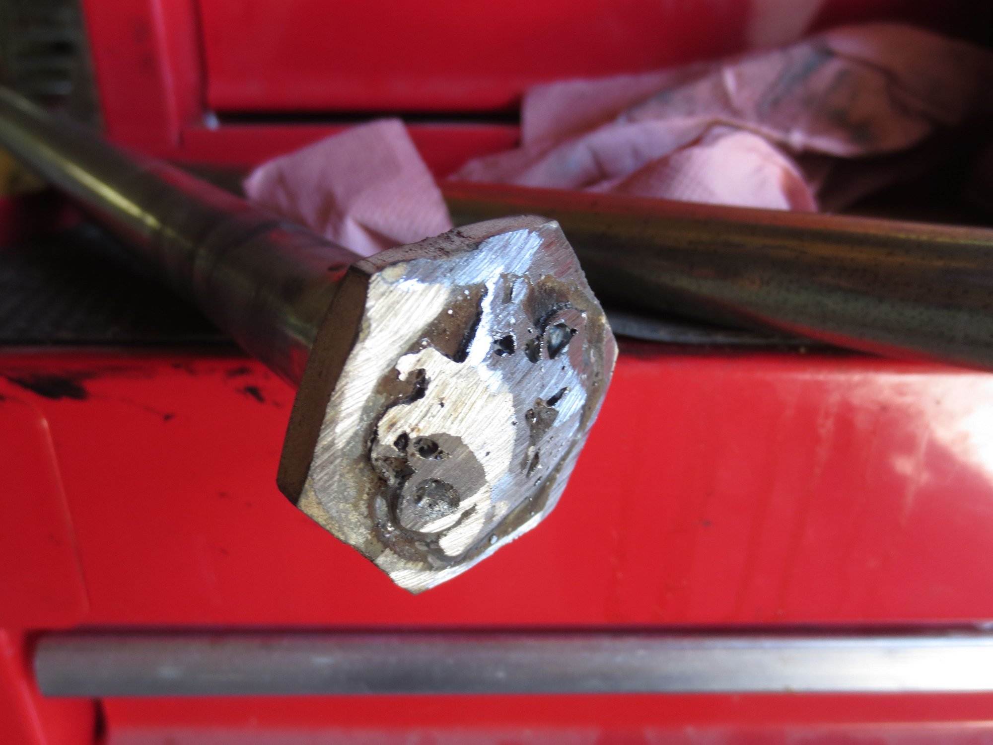

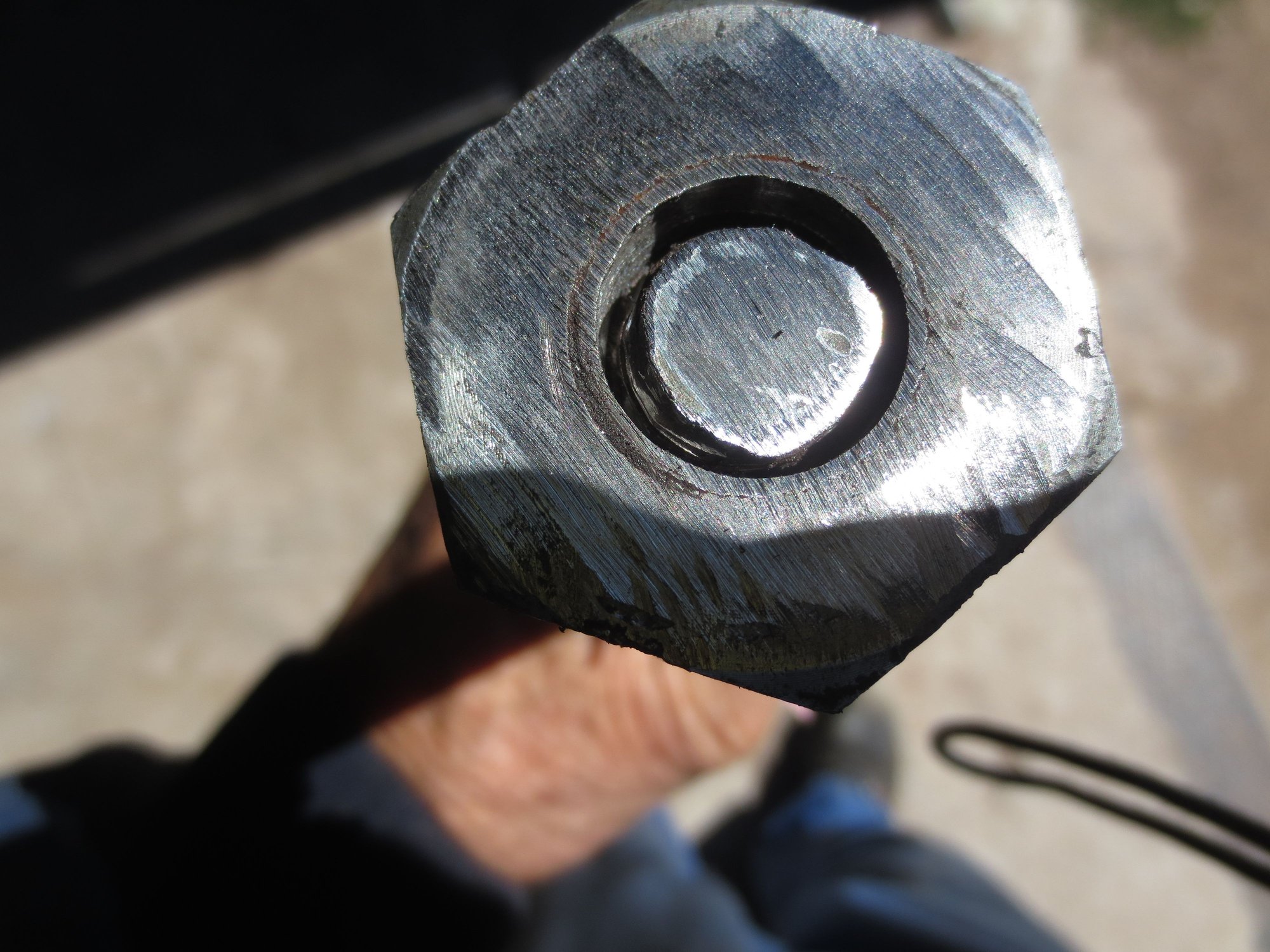

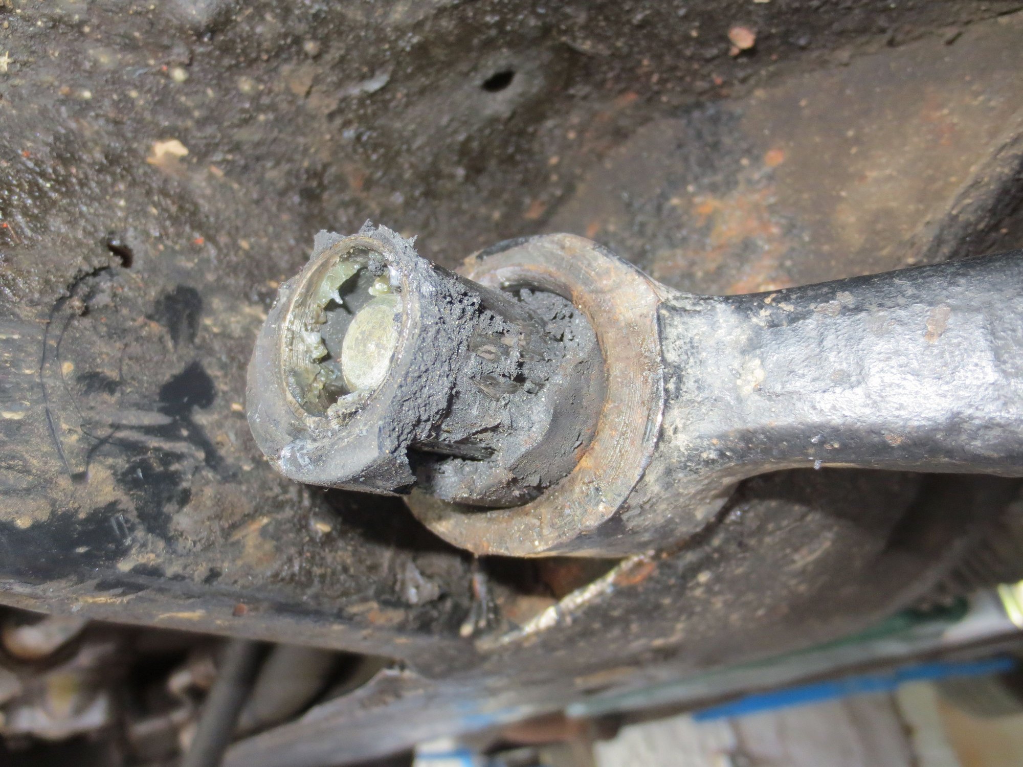

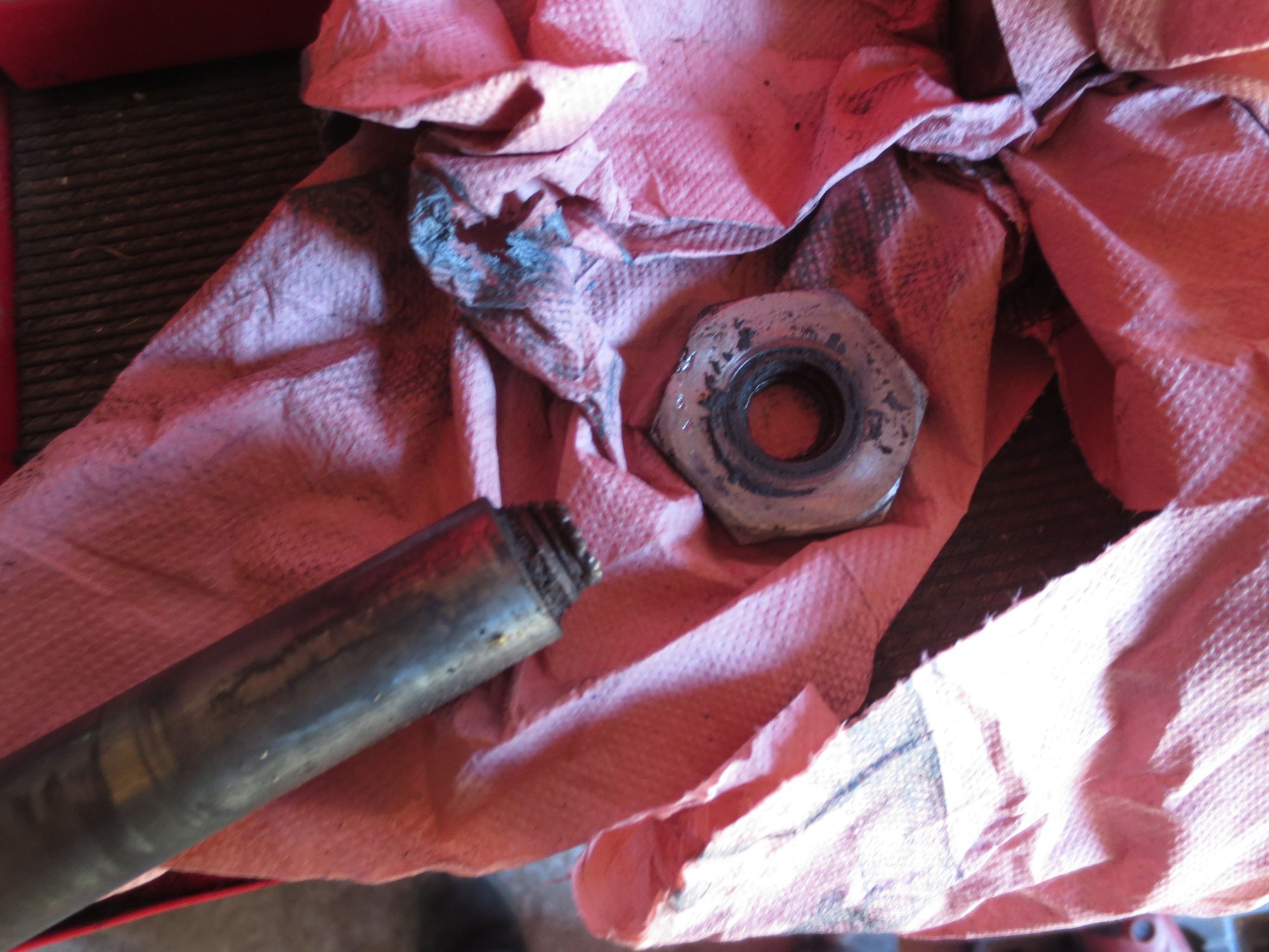

Yes, equally each side of the eye on the lower wishbones. The fixed end of the pin can become unfixed, especially with aftermarket pins. I had one come loose which meant I could not tighten the bush/pin assembly to torque using the castellated nut. A bit of weld on the fixed end is a good plan if you are not sure about it. photo attached. The special washers go with their grooved sides nearest the bush.
Red brake piston rubber grease is best to get the bushes into the eye. Buy some top notch aluminium loaded anti-seize grease for the pins where they go through the subframe. This is the absolute best stuff, sticks like s. to a b., never washes out, fantastic. Also use it on V12 spark plug threads.
https://www.cromwell.co.uk/shop/lubr.../p/MLY7035050E
When you are tightening up the bottom pin, the car MUST be on its wheels, by the way. The bushes work by the rubber element twisting/stretching one way or the other as the susepnsion moves, and they MUST be at their mid-point when the car is at its normal height. The special washers hold the metal inner of the bush solidly in place, the rubber does not move against the eye either. The wishbone moves by just the rubber element accomodating the suspension movement by giving enough. So if the pin is tightened up when the car is off its wheels (ie the suspension at full drop, at full bump (ie suspension up into the wheelarch as far as it will go) the bush rubber will tear, and you will have to do it all over again.

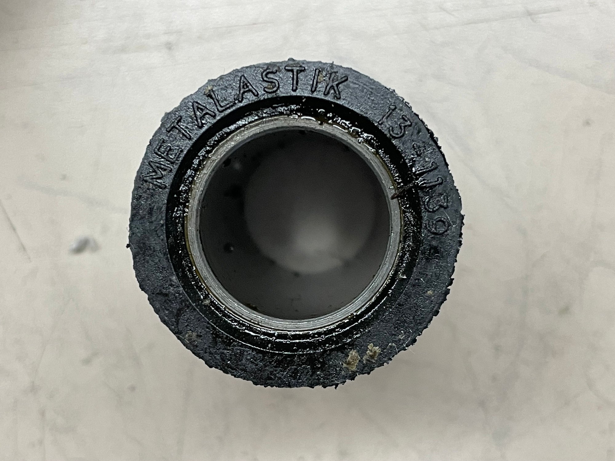

This is the reason that aftermarket lower wishbone bushes do not last; as the rubber used is not good enough to accomodate the suspesnion movement and just tears itself to bits. As well as the welded end on my pin, I attach a photo of an aftermarket bush after 4 weeks use! We all only learn the hard way!
