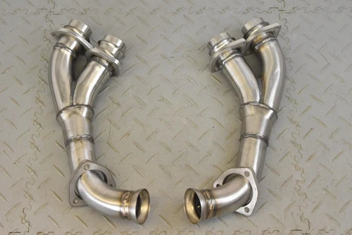

My plan is to eliminate the "CATS" and use the Euro style non-cat down pipes and I am looking for the cheap way to do this-- like used non cat down pipes.
I saw this used pair on Ebay and I want to know whether they will work on the 1990 V12 engine. I tried to attach the ebay ad but was not successful. The ad states that it is possible that they are from an E type or early '70s V12. The seller was not sure.
If anyone knows whether these will fit on the 1990 XJS please let me know so I can make the purchase.

The above pipes will not fit an HE V12 exhaust. As you can see from this photo, the downpipe is much longer on an HE V12
