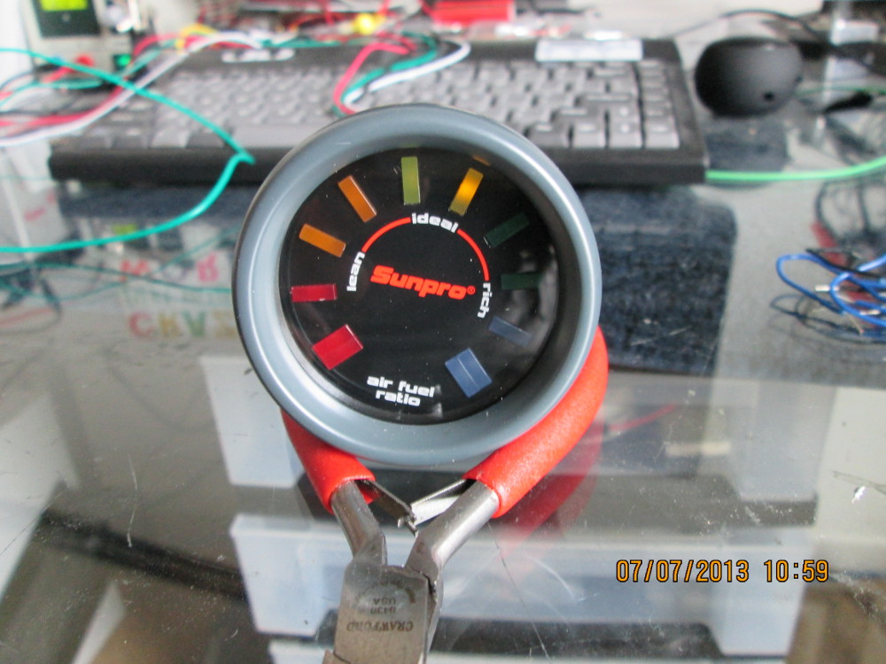

The air-fuel meter is a Sunpro. I hooked it up to a desktop power supply, and (as in the photo) it shows "ideal" around .3 volts. It's not the most expensive out there, and I've heard that if I'm not using wideband sensors the readings "may" be meaningless, but certainly something isn't quite right if I'm only getting 11 MPG on the highway.

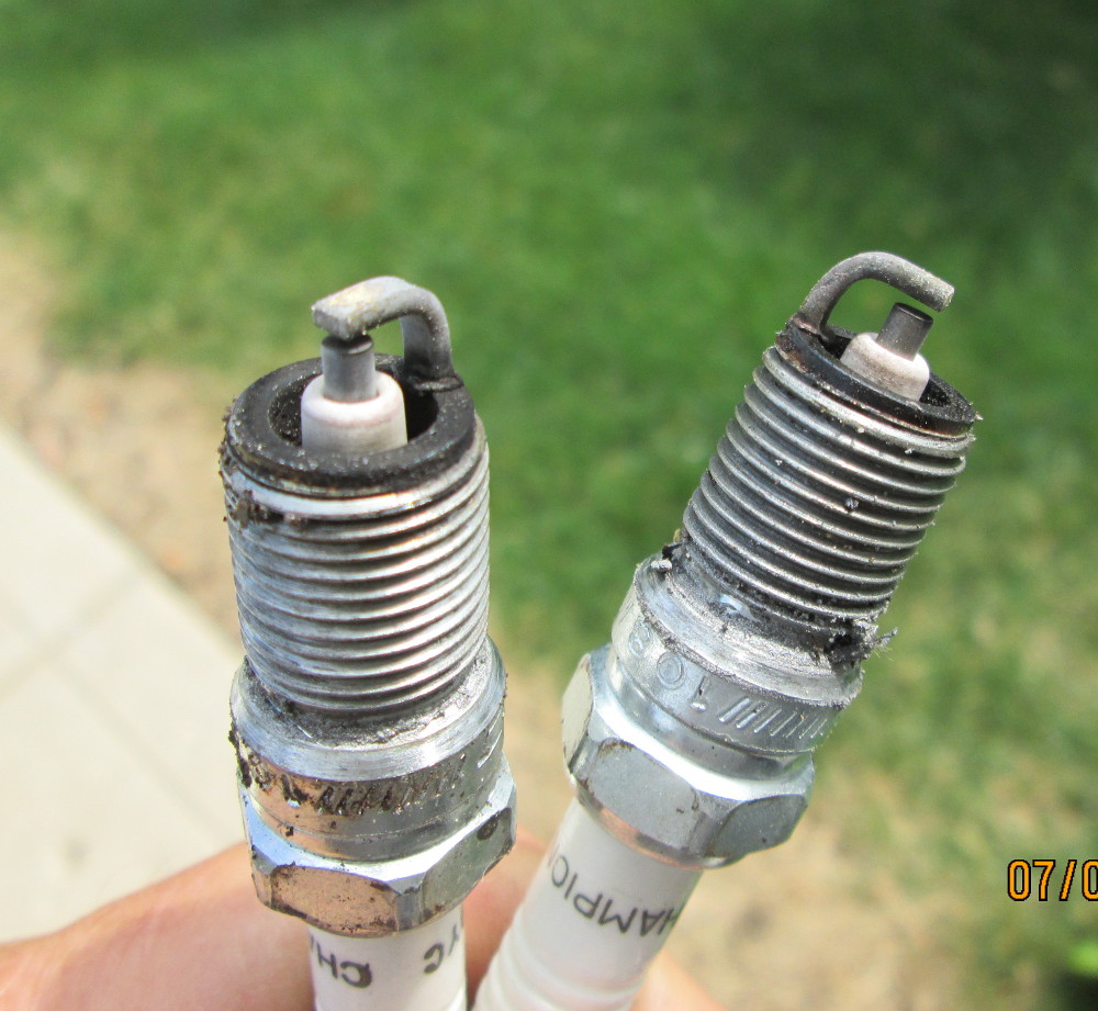

I then pulled the #1 plugs from each bank. Somehow I expected them to have more soot on them than they do.
So at the moment I'm scratching my head wondering if I am really running rich. Again, the only indication of a problem is the poor gas mileage.

I agree that the plugs don't show an over-fueling problem.

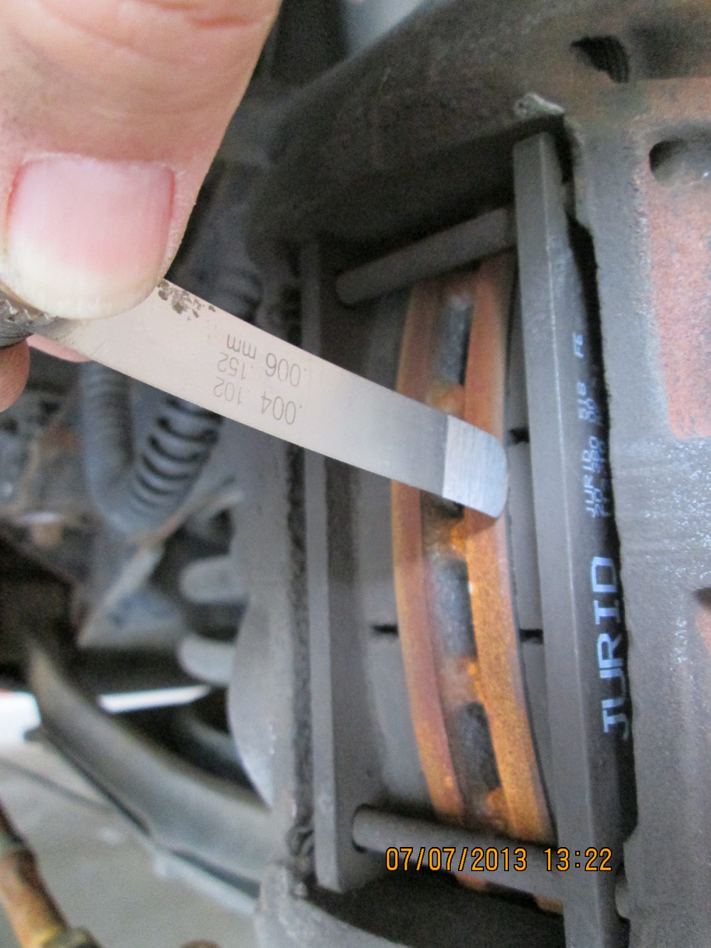

Anyway, I just pulled the LH front tire and then attempted to measure the gap between the brake pads and the disk. The narrowest blade on my feeler gauge is 0.004 inches (0.006 mm) and it wasn't even close to fitting between the pads and disk on either side. While I can turn the wheel hub by hand, I can hear some scraping. The car is in Park and the parking brake (which I think works on the rear axle only) is off.
I don't have a repair manual, so I don't know what this gap is supposed to be.

None, really. It's normal for the pads to lightly contact the brake rotors. There's no retraction springs or anything like that to pull 'em away.
If you can turn all four wheels easily by hand that's about as good as it gets. Naturally the rears will be somewhat harder to turn as you're also turning the drive axles, differential gears, etc.
