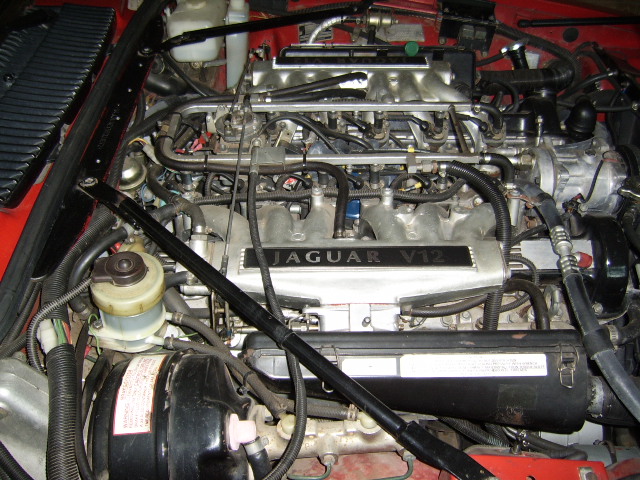

The previous owner was a jag mechanic and he redid all the fuel lines on the injectors. He used hose clamps?? Even though he is (was) a jag mechanic I am skeptical of his choice to use hose clamps. Some of them are cut through.
Should I replace all of these with injector clamps?
Old Sep 20, 2015 | 05:22 PM
TheWarlock's Avatar
Joined: Sep 2014
Posts: 366
Likes: 78
From: Dallas, TX
The short fuel injector hoses should not be clamped since they are barbed. Using a hose clamp on a barbed nipple leads to the hose tearing at the sharp barb ends.
The line leading to the fuel rail usually has Jag specific collars at the ends that mate to metal lines with specific bends. Here is an example:
Steal This Fuel Tank Return Hose 1982 1991 Jaguar XJS V12 Coupe New | eBay
They are not crimped, the collar serves to prevent the hose from expanding and thereby getting loose. The advise usually dispensed on the boards is to take your lines to a hydraulic shop and have them make the hoses with the collars using your current metal lines.
It looks like your wrench had decided to go the path of least resistance and cost. It's functional I guess.
So your saying there should not be any clamps at all. are there any reported issues resulting from using clamps?
As long as it is functional it is ok with me. However, I am still concerned about using hose clamps instead of fuel injector hose clamps.
Old Sep 20, 2015 | 08:30 PM
Doug's Avatar
Posts: 25,529
Likes: 11,724
From: Pacific Northwest USA
Right, no clamps at all. The nipples are barbed. The hoses just press on. That's it.
Barbed nipples + clamps = bad !
My findings after doing hundreds of EFI hoses on V12 engines.
Damage CAN occur to the "sharp" section of the barb that "bites" into the inner lining of the hose. Usually from a blade etc when cutting the old hose/s off.
This damage will ALWAYS leak fuel, no matter how many clamps are used, not good.
Choices, dependant on what item is damaged:
Replace the injector/s
Replace the fuel rail
Replace the other damaged component/s.
NOT VIABLE in the real world.
I CAREFULLY take the "nipple" and using a very fine "Wet/Dry" paper wrapped around that nipple, and remove the damage. This will ALSO remove the "sharpness" of the barbs, obviously. Some have been so damaged, I have had to use a very fine file (Contact Points File for those old enough to know what they are), and even MORE carefully file that nipple to remove that damage.
Once done, and the new 7.5mm EFI hoses fitted, NEW EFI stryle clamps are mandatory.
I have never had an issue with this rectification process.
GREAT CARE is required, as HIGH pressure fuel is being messed with, so if confidence is lacking, get the professionals involved, as safety is paramount in my book.
Just a side note: The PreHE has NO such arrangement. It has STANDARD swaged ends on the rail, and EFI clamps, and runs the same, if not higher fuel pressures.
A lot of these "upgrades" as they are called, were for production time restraints, and the next "upgrade" was o/ring seals between the rail and injector, as they simply "plug in".
At the very least l would change all the worm drive clamps to EFI style clamps. Ideally there should only be the ferrules and push on hose but it's up to you. If you disassemble one of the fuel rail joints check out the barbs, they are very sharp and very capable of cutting into the hose.
major paint to have to redo someone elses work. this guy was a jaguar mechanic at a reputable shop in silicon valley... I looked up 30R7 and it is a low pressure fuel hose... shouldn't it be high pressure hose...
I found this write up which I will follow when I get around to this, first is the cooling system.

Ok, so I will replace the hoses with 3m of Gates Gladiator 7.9mm high pressure fuel hose with no clamps on the rail unless I notice the nipples were cut then I sand with about a 500 grit and use an EFI clamp on the nipple. I use ferules on every other nipple which can be had here for $1.40 each. Get intake hose remanufactured at a hydraulic shop (hose and fittings in the bay area) and an R7 with clam is fine for outtake return hose. Use EFI clamps whenever clamps are needed.
Get a new harness if needed or make your own.
Back to my original post and on to the cooling system:
It was mentioned hoses, stats and radiator every 5 years? Does that mean replace the radiator? - Im assuming it means a flush? I would think every two years for a flush. Based on experience Iam going to stick with every 10 years for thermostat replacement. It seems common for them to go after 10 years.
I guess what I am getting at here is an updated maintenance schedule based on knowledge gained through the years.
Aagree with your work plan in principle.
If you find ANY nipples that need sanding off, I would use 1000 W&D (Wet and Dry), so the small scratches will be minimised. The 500 sounds a tad rougn to me, but I am a strange guy.
THEN, if you have to sand ONE, do them ALL, then they ar all the same, and teh thought process in the brain can be used for other things. Thats what happened with mine. 6 at random were very sad, so I sanded the lot, then clamped them ALL.
I would use that EFI spec hose on ALL the hoses, again, it keeps the guess work to a minimum.
I dont run that RH FPR, so my supply hose simply goes from under the brake booster (RHD) direct to the fuel filter (now located inside the engine bay), then direct to the fuel rail inlet.
The radiator part is to remove and flush (professionally, not the garden hose), and I simply doo all the hoses/belts/stats while there is so much more room. The time frame just sits well with me, and since ALL my Jags are Daily Drivers, teh kms mount up real quick (usually 40K KMS /year). First signs of radiator issues is teh temp gauge sitting a tad higher than it did last summer, and teh thermo fans coming ON a few times more than last summer, and as I said, the 5 years just fits in there nicely. Our summers are 44c++, so it has to work hard, and I drive it like I stole it, just as it was designed.
