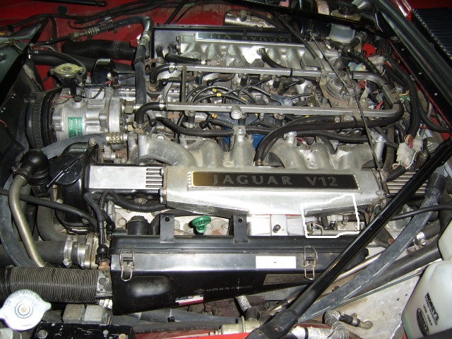

Originally Posted by Grant Francis
Our summers are 44c++, so it has to work hard, and I drive it like I stole it, just as it was designed.
Attachment 119027
Attachment 119028
Ok Grant, lets talk about those pics of your clean looking engine bay, shall we?
First off is that a Pre HE we're looking at? What model year?
I see you've dumped the CC and gone to a smaller ac compressor (Sanden?), and we've previously heard you say that you like to relocate the coil and amp to above the radiator. Got pics of the way you're routing the wiring? Single coil or dual?
I see the FPR is a single unit as you've described, and the fuel cooler is gone. The fuel temp switch on the rail is gone too, so no bumping up the fuel pressure under hot rail conditions.
I see the overrun valve for closed throttle air is removed, wont this cause backfires ? I understand the later cars had this function moved to the ecu which cut fuel under closed throttle.
It appears that you've plugged up most of the vacuum lines that typically cross the vee, and have a single line that follows the contour of the fuel rail. Can you please provide a little more detail on what you did and it's effects on driveability? Jaguar added more and more of these lines for a reason I take it.
In general, I'm trying to declutter my engine bay (88 XJ12), but i don't want to do anything that kills the refinement that attracts me to the V12 and Jaguar. I've removed the air pump and air rails, as well as the CC since I don't use it. I also want to retain some "quaint" features like the fuel cooler, dual FPRs, dual coils since it's what gives this beast it's Quixotic character if you will.
1) NOPE, 1985 HE.
2) Amp out the front, alongside where the 2nd coil once lived. The wiring was simply part of the 100% rewire of the engine bay a very long time ago, which included the removal of the shielded wire inside the engine bay. The wiring simply runs up the RH inner guard, around the brake booster, and along the rear, before routing onto the LH inlet, and the distributor connector. It runs a single coil.
3) Correct, never had an issue. I run a PreHE unit set at 31psi.
4) Never had a backfire. The car has a 16CU ECU fitted, coz the 6CU died, as they do, and I simply grabbed the 16 from a 1988 wreck. Plug and play fitment.
5) I dumped the AVV, and the balance pipe, so the hoses down the fuel rail are for the ECU vac supply. The engine breather is to the outside, so no PCV, etc. The rest of the vac lines were once for emission stuff, and it was all very sad, and since no smog testing, gone it is. Jag added more and more for USA emission numbers, we dont have that stuff. Driveability, AWESOME, goes like stink. Remember, it also has the BIG throttle discs, and free flow exhaust, and obviously NO Cats (not applicable down here in 1985).
7) Declutter wil depend on the laws in your market, ours are simple compared to USA.
Most of this took place when I went in for the EFI loom rebuild, and decided to move it up top, and then other wires "cracked and crunched", so I ripped it ALL out at the bulkhead connectors, and started from zero.
A/c compressor, thermo fans, cruise relocated outside the engine bay, EFI ballast outside the engine bay, other electrical stuff also moved outside the engine bay, atmospheric coolant tank relocated inside the engine bay, trans cooler removed from the radiator, p/steer cooler removed totally, ignition amp out the front of the radiator, fuel filter relocated inside the engine bay, TPS replaced with an XJ40 unit, the throttle capstan spacers were shortened, and the fuel rail lowered by shortening the hoses, COLD air intakes installed, foam medium air filters made and installed, HEAPS of things looked at too many times, and relocated, removed, altered to suit MY needs.
It took 2 months.
This was a Daily Driver, and also took us twice around the coast road of our island (25000kms each time), and it did what it did 100%. One oil light switch was all that failed in all that travel. The beast returned 11.2l/100kms economy at the same time.
That is why I get a tad testy when people bag the V12, and the XJ-S, it is NOT the car at fault here, it is the previous shortcomings of the person/s looking after it, and mine was no different.
Sadly I sold it due to my physical disability making entry and exit way too awkward and painful. SAD SAD day, and it si still missed. Our 2 S Type V6's are awesome in their own right, but that V12 is something not easily replaced.
The PreHE I was referring to is "Sir Arthur" in my garage, a 1976 S2 XJ12 Sedan, which was "her" daily driver.

Originally Posted by baxtor
At the very least l would change all the worm drive clamps to EFI style clamps. Ideally there should only be the ferrules and push on hose but it's up to you. If you disassemble one of the fuel rail joints check out the barbs, they are very sharp and very capable of cutting into the hose.
So where can one get push on hose? I have SAE30 R9 thermoid hose. I called the manufacturer and they said it is not push on hose. the only place I could find something that claims is push on is push-lok hose from jegs, which is not good for all fuel types.
It seems like others are just getting fuel injector hose and pushing it on? no issues with this?
I will most likely have severe barb damage. I replaced the hose on the fuel intake to the rail and the barb was so damaged I had to file it practically off to remove the damage. the knife marks were insanely deep. the guy just didnt pay any attention at all to not damaging the barbs. so regular non push on hose should work. however, if I find the barbs are perfect on the rail, I will be trying to find push on hose that is SAE30 R9. if such a thing exists.
Old Oct 2, 2015 | 08:34 PM
  #39
baxtor's Avatar
Joined: Jun 2013
Posts: 2,122
Likes: 1,383
From: Australia
Regular R9 hose of the correct size is all you need along with the relevant ferrules. If however you find the barbs are seriously damaged l would suggest deliberately filing the very sharp barb edges slightly and then use the EFI clamps on them.
I would not use clamps on unmodified barbs, those edges are like knife blades.
