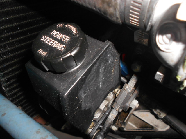

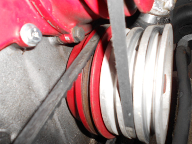

different approach! CHROME.
pix water pipes, front crossover and side pipes, plus my coated exhaust manifolds.
looks dirty,been driven it and it shows, been 20yrs.
coating cleans up nice with WD40(when cold).
also my front aluminum crank pulley, and(for real) a VIPER power steering pump(very light weight). notice all chrome head nuts.
