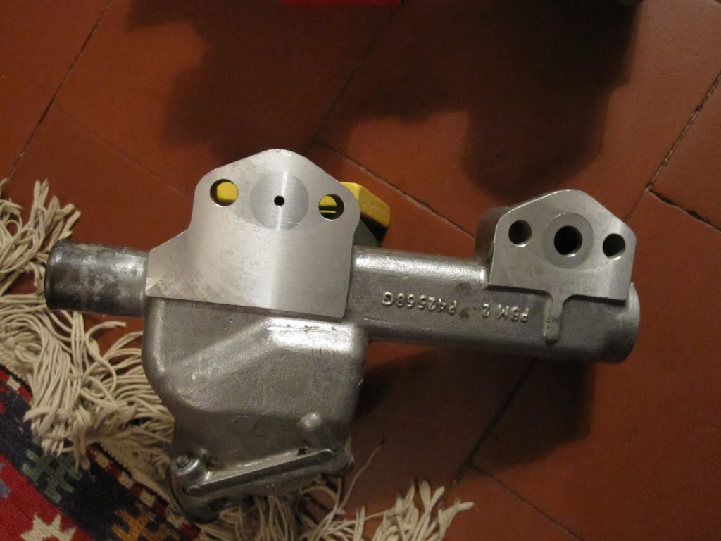

Stainless water rails a good idea. The existing rails may be Ok but equally may be rusted a bit. All the gaskets and top hat water rail/manifold seals still available from Jaguar. There is a theory that the water at the back of the engine gets less well circulated and that the water 'short circuits' round the front of the engine. This can be ameliorated by reducing the size of the holes in the front manifolds as shown here:
The hole nearest the front is about 4mm and the next one about 12mm. This is standard practice apparently by the racers. Careful how you undo the water manifold bolts as they can snap, though mine were no problem.

Gregg, how's that been done welded or plugged?
Greg
Plugged, interference fit and then machined flat.
Greg

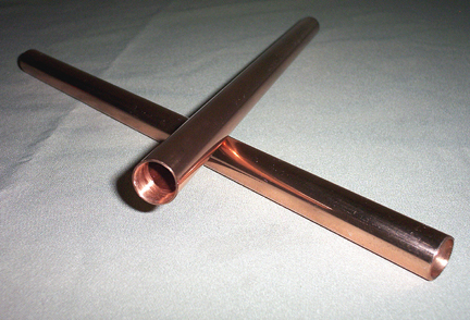

I like the look of copper for the coolant rails. I think the look pays homage to grand motorcars of the 20s & 30s.
I've polished and clear-coated at least a dozen pair of copper pipes without adding an additional ring at each end, and have installed them on two of my own engines. I never had any complaints of leaks from customers I sold the pipes to, nor, have I ever had leaks on my engines after installing. The rubber top hat seals heat up and bond to the pipes and housings very well without additional sealant.
Attachment 91820 Attachment 91821
Scott, do you happen to have a picture of a copper pipe fitted? I am so tempted to use copper, as it just has that classic look you mentioned
And cheers about the housing bond bush things... Sounds perfect!

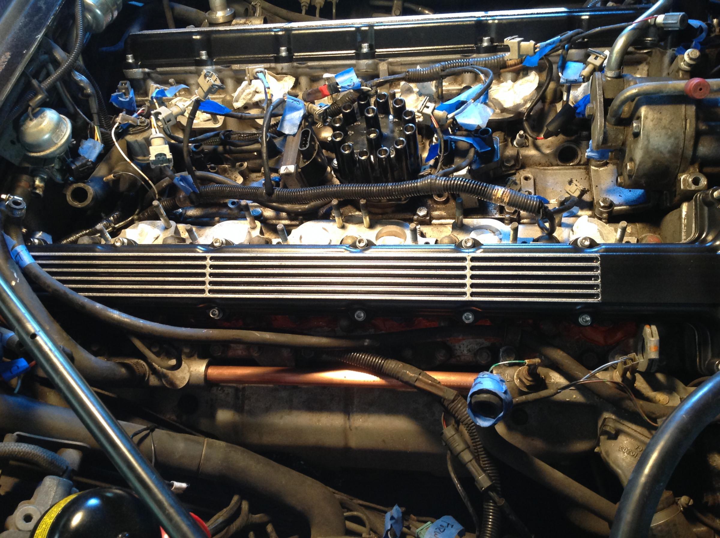

Likes: 298
From: Mississippi
Here you go.
They are kinda buried under all the intake paraphernalia, so someone really has to be checking out your motor pretty closely to notice them, but, they really are like jewels when they're in an organized engine bay.
