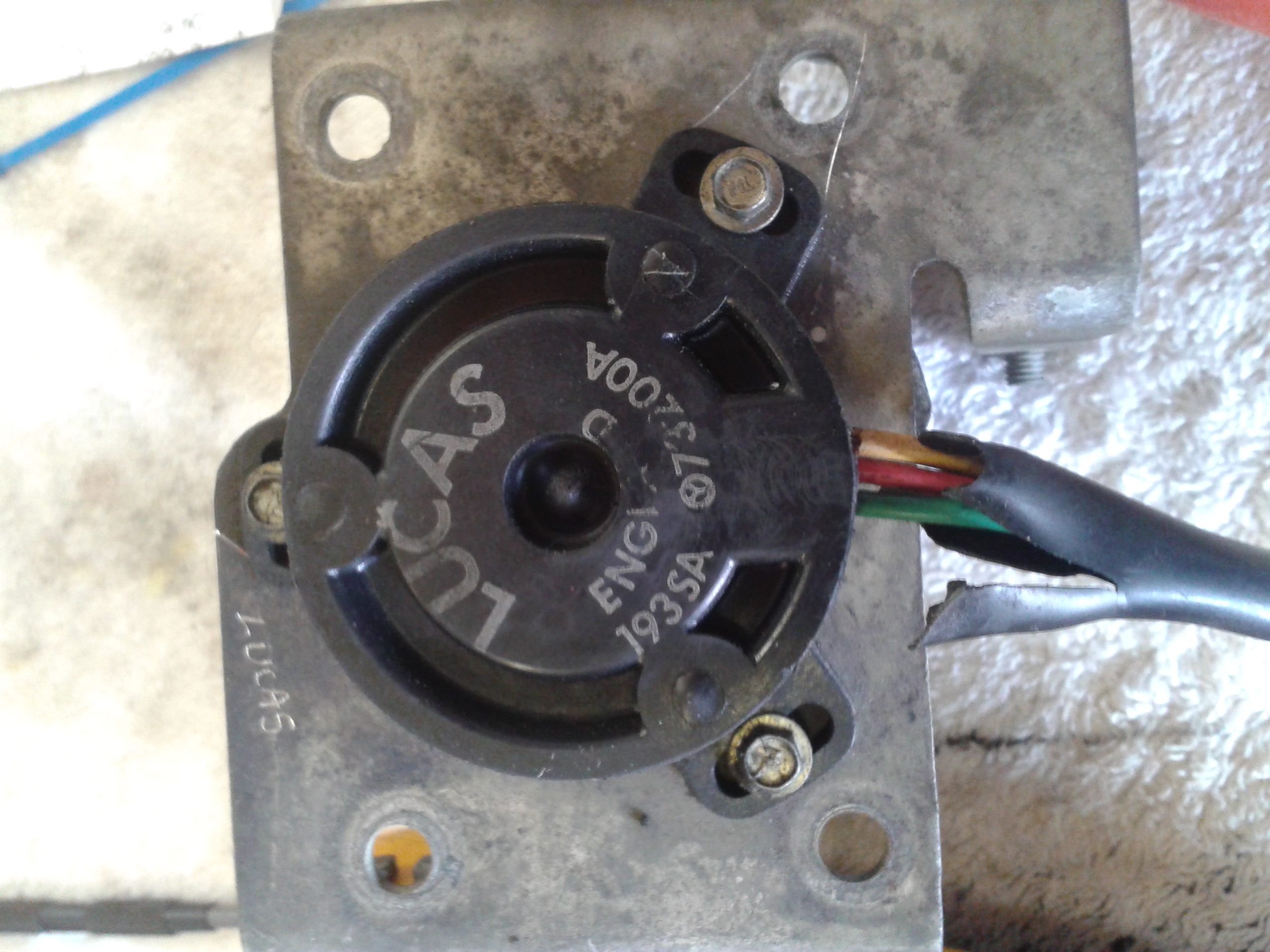

2 The TPS fitted to this car doesn't conform to the ones I've seen on this and other sources for a V12 1982 car. I've attempted to upload pictures below
I adjusted this one after some consideration to make the TPS get to the starting position of its rotation while the throttle capstan is at rest, with the throttle cable slightly loose. This TPS was centred on its slots when I removed the platform.
Of the three wires exiting the TPS, one appears to be a ground, the other increases in resistance as the capstan rotates and the other reduces.
Is this consistent with the $$ upgrade TPS mentioned earlier?
The car seems to run at a lower idle, perhaps even too low, but the idle adjust screw on the extra air valve seems to make a difference now while turning it out from fully in by approx 1-1/2 turn. Never seemed to make a difference before.
Exhaust fumes smell very rich - is there an adjustment on the ECU for mixture?
Looks to be a hex shaped recess on the side of the ECU - does this adjust with an allen key? clockwise for richer?
