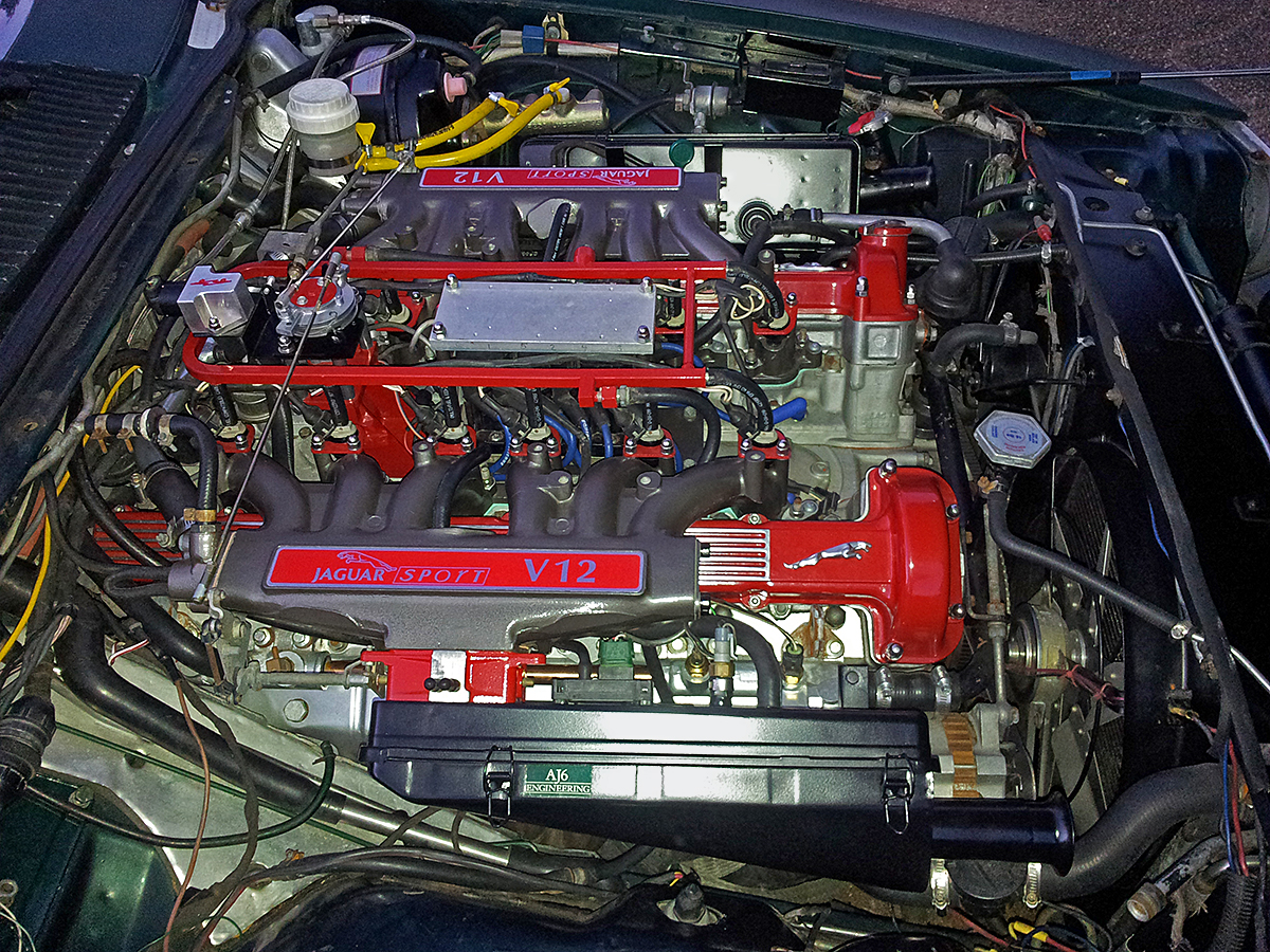

Yep. When done right, and the engine is tidied up a bit, the 5.3l can look stunning...
ed up the blasted parts today. Beautiful! Lovely job!
Before:
After:
