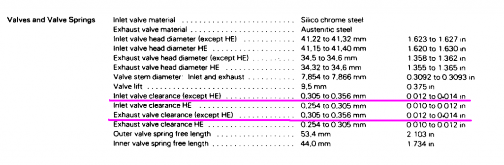

I REALLY hope that is a typo Mish_Mish

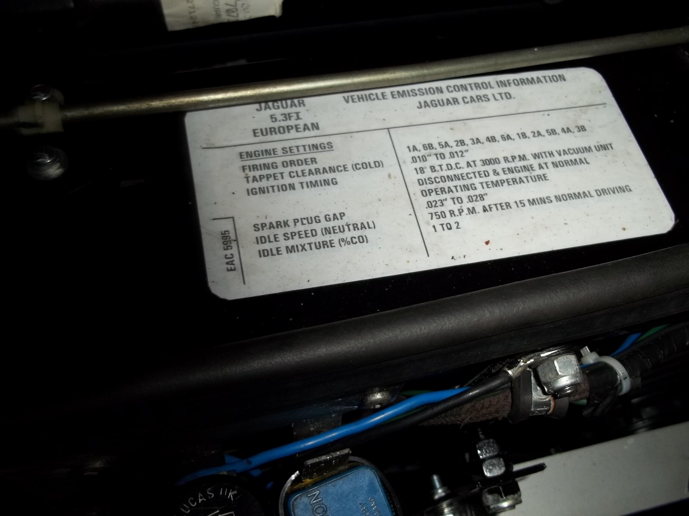

when I changed my heads I set the clearances to 0015" as per the
information for improved mpg in experience in a book, it was too noisy for me, so I had to go through the agro of re-shimming them all back to 0012".
I hope the big gaps didn't do excessive wear
my engine plate states 0012" -0014" for 1984 HE
looking at the setting above maybe the u.s. spec is different

then is WAS a typo, thank god...
Re-read your original post. It says .12 and .14 not .012 and .014

that scan is from the English jaguar workshop manual, there is only one publication. Details are given for differences in different specs, but there is only one spec for intake and exhaust clearances. Maybe the info was later changed or confused, my workshop manuals are from 1987

this is the plate on my radiator cross panel I was wrong about gaps, it only states 12-14 in my Haynes book, so I do tend to go with the engine plate fitted at the factory, mind you B.L. didn't know their **** from their elbow.

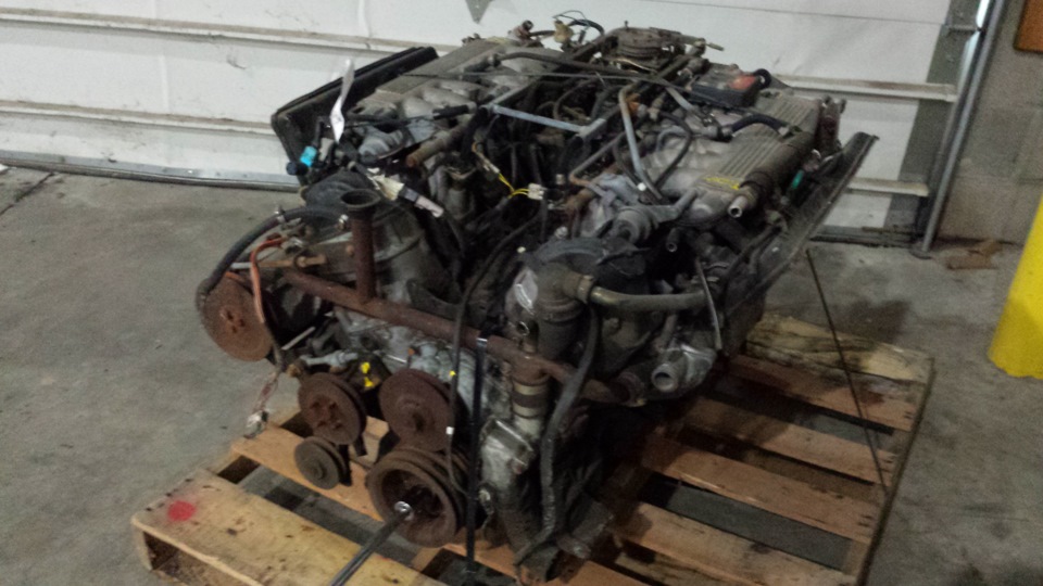

It seems to run perfect now, so I am not sure what it was. Motor I have is very clean and does not seem to have previous overheat issues. However, since those become harder to get, look what I just got at a local junkyard
80K miles, seems to spin smooth and has most of accessories intact, $500!

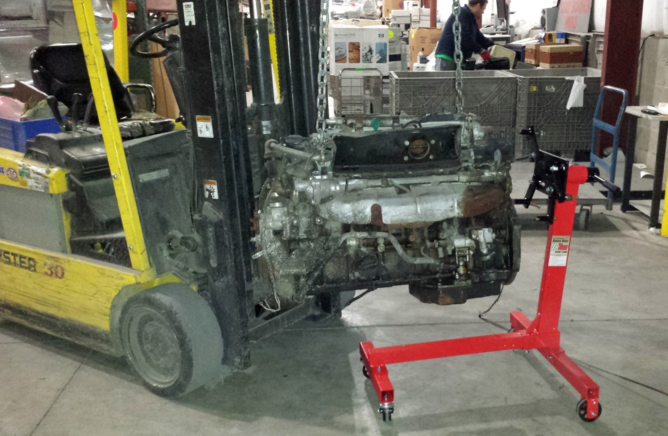

Motor is post Leyland, '88 and seems to be in OK shape. I had to buy and weld reinforce $60 stand for it. Slowly I will break it down and build it as a perfect spare.
