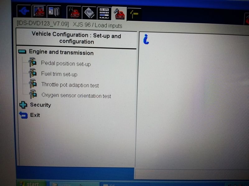

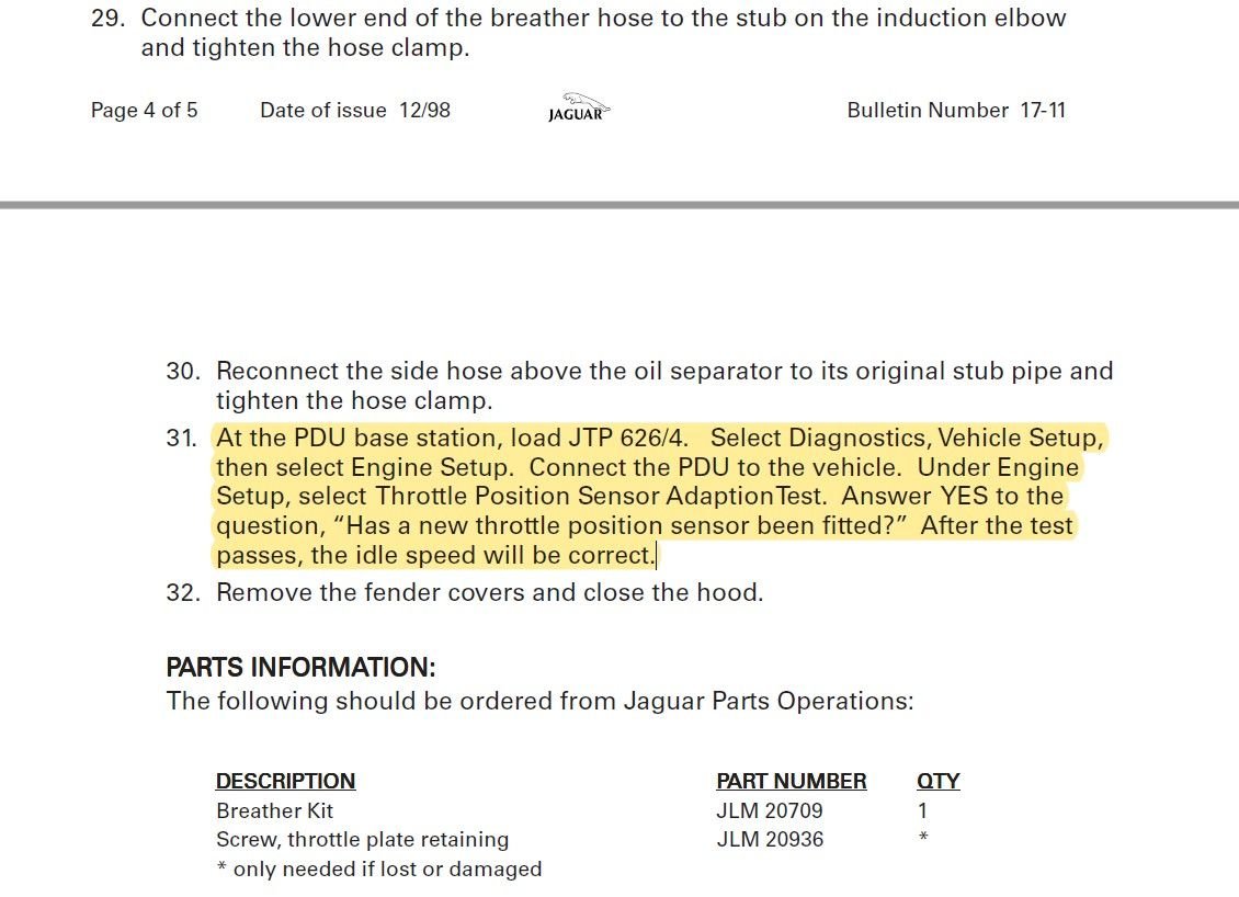

Hi Jim,
as Vee menitioned in his post earlier the probability is high that the Throttle Position Sensor Adaption Test has to be completed on your car.
The ECU of the AJ16 engine does not control the IACV if the detected Throttle Position is out of range.
Unfortunately, the acceptable range of the throttle position at idle (closed) is very narrow and through the years the TPS at the idle position is drifting out of this range.
For the procedure please also see the attached screenshots.
You need a dealer who has the appropriate diagnostic software (PDU, WDS or IDS) to complete this adpation setting. It may be challenging to find one ...
