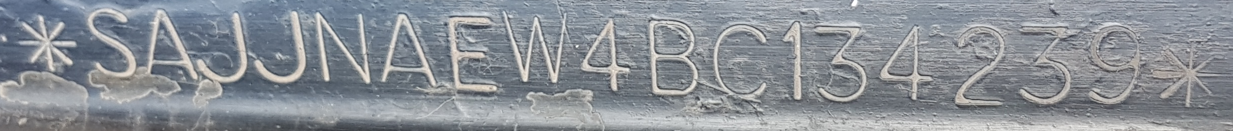

Old May 16, 2018 | 08:00 AM
Segfault's Avatar
Joined: May 2018
Posts: 221
Likes: 43
From: Acadiana
According to the sheet I attached earlier it is 1986. But who knows, this VIN decoding is rather confusing. Attached a picture. I happen to know there is another place with VIN somewhere underneath, it was checked by authorities and it did match.

Old May 16, 2018 | 08:15 AM
baxtor's Avatar
Joined: Jun 2013
Posts: 2,132
Likes: 1,389
From: Australia
Originally Posted by bladerunner919
I'm assuming the VIN you posted was a typo, because you list the 10th digit as 'B' which is a 1981 build?
A "B" in 10th position indicates a coupe in the case of German or most other non US cars.
The same letter (B) in that position for US, Canada and Korean cars is indeed "1981"
Old May 16, 2018 | 10:42 AM
Segfault's Avatar
Joined: May 2018
Posts: 221
Likes: 43
From: Acadiana
Thanks! This explains it, I already got worried.
