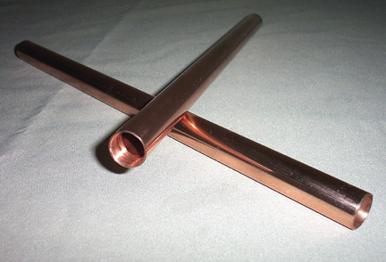

Unbolt the manifolds. How do you expect to reinstall the coolant pipes with the coolant manifolds still bolted to the heads?
By the way, chances are good that the ends of your coolant pipes are rusting and developing pinholes. if you're going to have the pipes off anyways, you should replace them with something that wont rust out on you. I polished and clear coated some schedule 40 copper, which I think makes the motor look more like the classic motors of the 20s and 30s. Another good material is stainless steel.

Normally when I go through "The Book" and look for techniques or ideas, I pretty much try to follow what's in there. But when I read about using Vice Grips and a Hammer to remove the rails (page 209), well...... that didn't seem to fit in with the "take your time, do it once and do it right" philosophy. However, I must admit, it does seem tempting to try a short cut. Especially since, as I said earlier, I've got Jag parts all over the garage (my wife has started calling it "Kitty Litter") and I just want to get this done! But no, I'll resist. Partially because I have been considering using copper pipes and a pair of grips on those will just ruin the effect.
