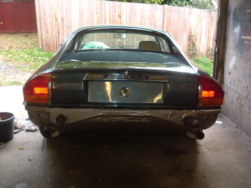

I had the same thing except the link had pulled off the handle, I drilled a
in the centre under the licence plate and it was easy but I cant remember
what made it easy, it wasn't hard once I could grab the rod. ignore the black area the hole in in the middle

The hole near the center will do the trick. My car has a 1/2" hole drilled a little right of center of the tag mount, and it is perfect for sticking in a screwdriver, and prying up on the release mechanism.

ok great,thanks for info.one question.,so if i drill hole exactly in middle behind license plate i will see acuator rod from lock cylinder? does it run vertical or horizontal?is 1/4 " hole big enough?

I only had a 1/4 hole but I cant remember (wasn't memorable) so must have been easy. what I put in it, but a grommet to finish
