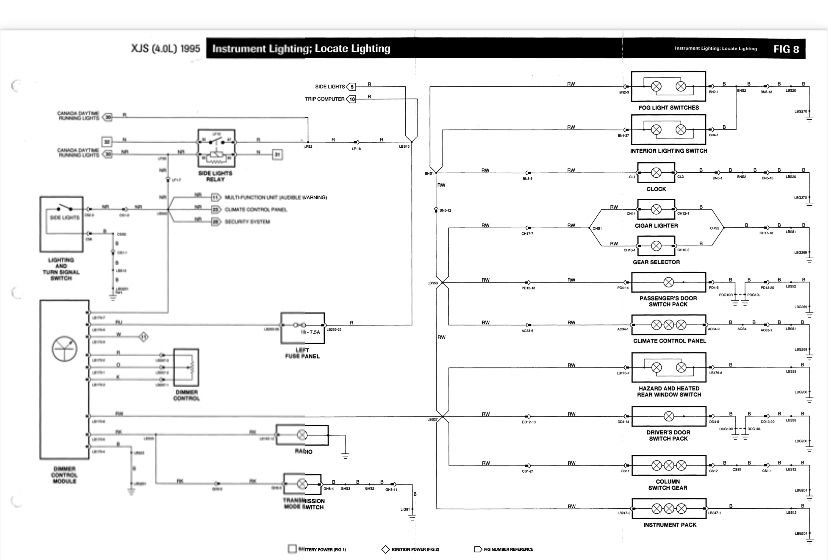

Hi gents, haven’t been around here much recently.....
I was wanting to change out a burned bulb in my climate control panel and was trying to take the burned bulb out with a tiny metal screwdriver....unfortunately I had the lights on as I was doing it, so I shorted something out. Now the panel won’t come on ......All the other interior lights are working. I can’t find the fuse for this in my diagram, so I am not sure exactly what I did. Thanks

I did EXACTLY the same on my 94 XJS several years ago. I could NOT find the fuse either. I ended up replacing the metal computor board that is close to/behind the climate control panel (where you would press the buttons to control the climate system). I felt totally stupid NOT disconnecting the battery!
Richard
