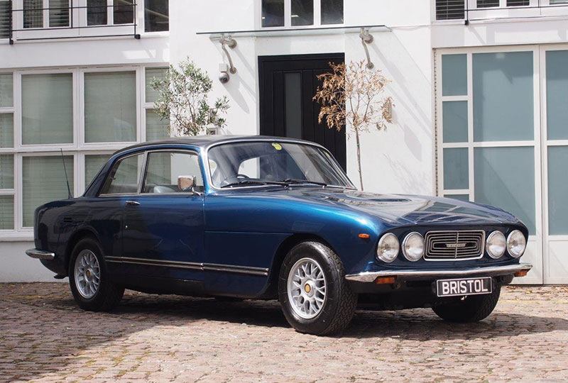

put those on an XJS and people will think you really hanker for a Bristol !!

411
