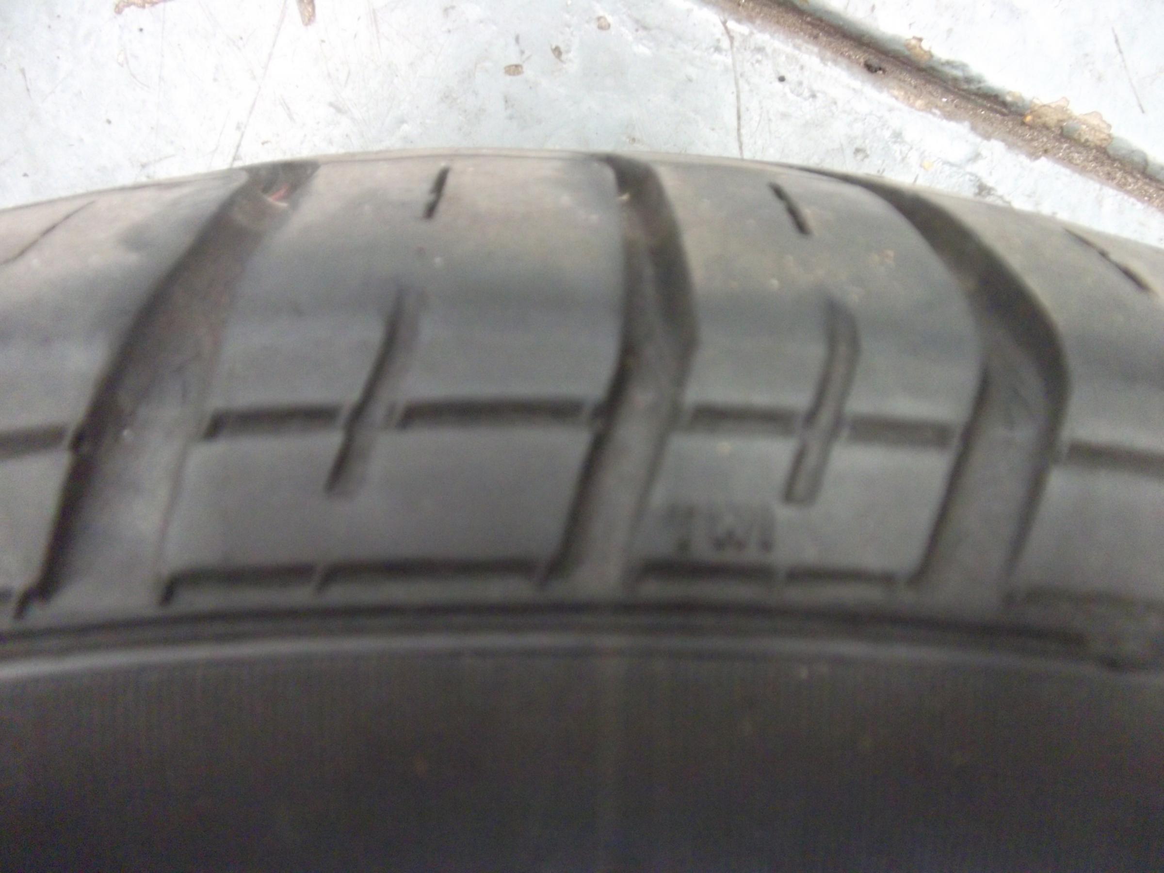

The Squeal is coming from the Front Tyres.
Looks like you were right about the 'Tracking' Take a look at the Tyre Pic and you can see a lot of wear on the inside edge and this was on a nearly new Pirelli.
Finding a good garage who can do the job could be a problem.
Maybe it wouldn't do any harm if I had a go myself? (Trial & Error)
If so what should I do?

OB, maybe this is what happened:
Someone in the past did a full alignment on the car while that bushing was in the condition you found it; missing.
After you "replaced" that bushing the true adjustment of the alignment came to light, and it is now Way Off!!
Normally, front alignment isn't a DIY affair as it requires specialized tools, turn tables, leveling gauges and that sort of stuff, none of which is cheap.
Ask around for a reputable shop that your friends like and take your car there for a complete front end tune-up.
If you're reluctant, ask yourself how many tires can you afford to shred in this manner before you bite the bullet and have it done right?

They are Pirelli's and they are not wearing in, they are wearing out!

DIY alignment just about impossible. Ask around and find a garage with a laser tracker with the reputation of knowing how to use it. Then ask them to set it up at 1/4° toe IN. The track rods on BOTH sides of the rack need to be independently adjusted, rack always centred, to give the correct reading on each tyre. Not all operatives understand this, and some just wind one side in or out to give the required overall toe - leaving the rack uncentred and the steering arm angles each side different = DISASTER.
Centering the rack is the most important thing. My car has been fitted with the later ZF rack which has a rubber bung in the rack, just to the left of the steering connection, hiding a hole into which a 4mm rod goes, and goes in further when the rack is centred. If your rack is an earlier type, I do not know if it has this feature or not. If not, usually the laser trackers turn from one full lock to the other and calculate the central position from those two extremes.
Overall, I agree with Steve's analysis, but an alignment is a good idea in any circs. You can forget about all the BS (I bravely disagree with the Great Palm over this) about special tools, suspension height setting etc etc, never done it, never needed to, never met anyone who has or any garage that does. The only thing you can set easily on an XJS is the toe. Camber is a major job and cannot be changed easily, so no need to worry about that at the garage.
As I mentioned before, if the thing rolls straight and tracks well on long corners without constant sterring corrections, the alignment is not far out. As for the tyre wear, if they are brand new, not old brand new, tyres then the track only needs to be 1/2° out, I have found, to produce this sort of wear.

The new Shock Absorber Bushes that I made myself, have totally transformed my Car, way beyond my own expectations.
She used to rattle and bang so much, I thought She was falling to bits but now (apart from the front wheel squeal) She drives as smooth as Silk and handles like a really proper Sports Car.
So as 'Greg' said the squealing was not to do with the Bushes, I am going to make some more, for my other XJS that I am
Before that I had Bridgestones and I loved them, unfortunately they didn't last...I don't think I got to 30,000 miles on them.
Anyways, I was referring to your Upper Control Arm bushings. If you did the ball joints, I'm kinda stunned you didn't get those either. With the upper ball joint off, I can't image how it would add 30 minutes to the job.
Failing bushings can make it hard for an alignment to be consistent. Not saying it's your problem, but they're not expensive and it's a straightforward project to tackle.
