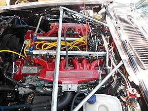

exactly why i went with 5/8" inside diameter solid aluminum rails.
NO socalled fuel hoses at all.
injectors have hi-pressure O-rings top and bottom, and all lines are ultra hi pressure stainless flex and aeroquip fittings .
lot of work but should last as long as i do?
Attached Thumbnails Whelp that was a close one...-dscn8893.jpg   Whelp that was a close one...-jag-strut-brace-mom-ridin-shot-gun-v12-exhuast-mani-002.jpg
thats cool 👍🏼
What fans are those? Tell me how you set it up. I want to do that exact set up. What hoses, and how did you get them to fit. I have a 1992 xjs 5.3. Please let me know what you did.
