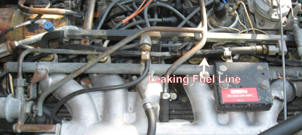

Looking for suggestions on good places to buy XJS parts. I need both new and used parts of all kinds.
Right now I'm looking for a Cruise Control Cable, Fuel Line, Micro Switch and some new Carpets/Floormats.
Any suggestions?

Leaking Fuel Line

You can remove that fuel line, cut off the hose, and press on a new section of 5/16" fuel injection hose. Same for the feed hose on the other side.
IF new fuel lines are still available from Jaguar they'll be very expensive....I paid nearly $400 for 4 sections ten years ago.
The switch is a common electronic/appliance store item. Google "Snap Action Micro Switch". Or any of the usual Jag vendors will have one
