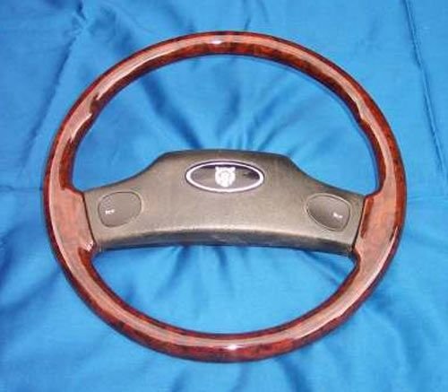

Was wondering will work in my 1984 XJS if the steering wheel pictured or is the horn contacts different

It should work fine.
It appears to be the same wheel as pictured in this thread (scroll down a bit)......
https://www.jaguarforums.com/forum/x...-wheel-210584/
.....but with a wood rim added.
If so, it'll bolt-on without modifications; the horn contacts work the same.
1980s vintage XJSs and Series III sedans have the same steering wheel and horn mountings/arrangements.
