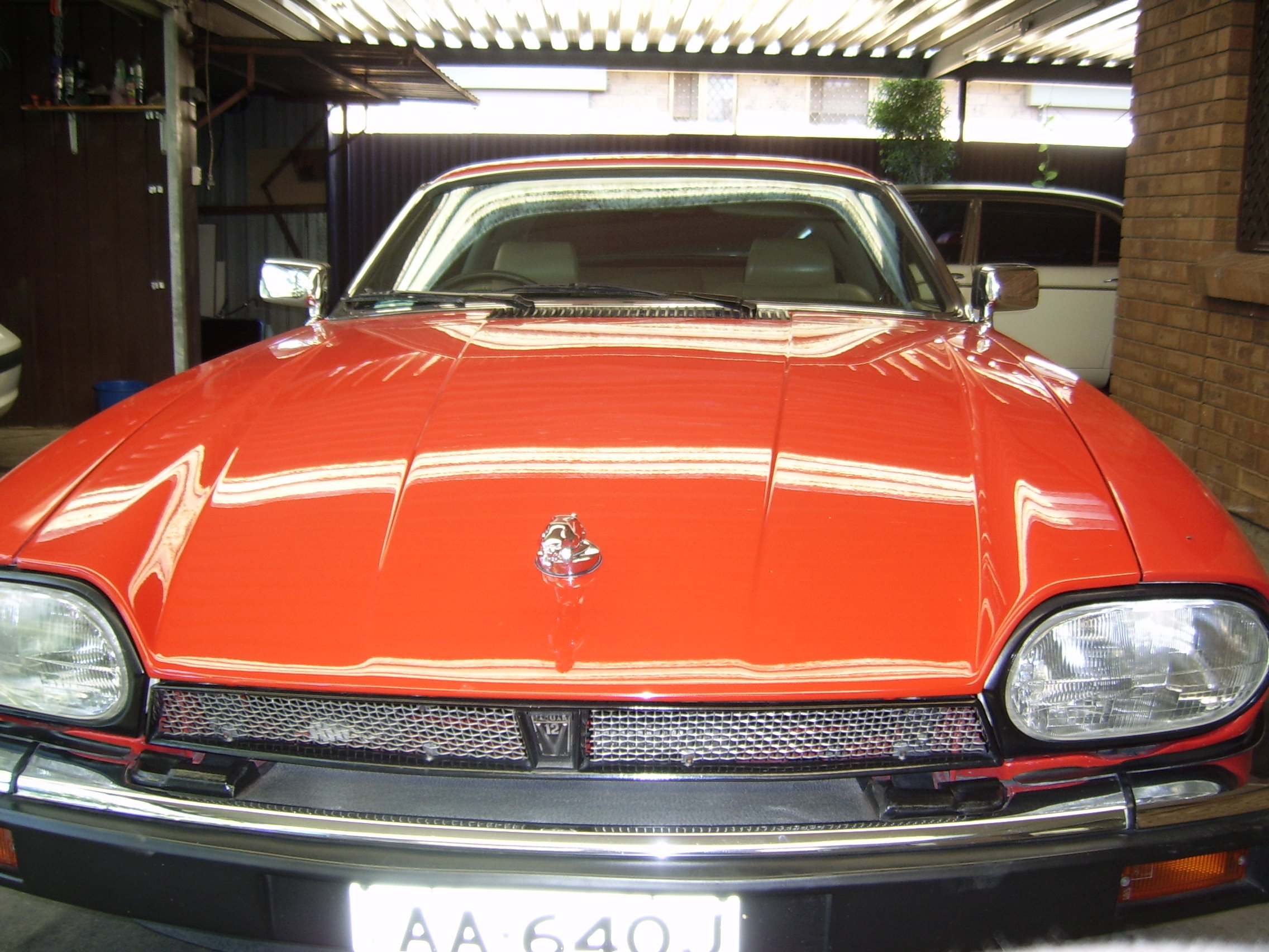

This is mine.
1985 Coupe. RHD beast.
And YES, I dicked around for ages to get them where I wanted them.
I put a slight "kink" in the arm/s, just at the blade hook area.
Those "pin style" arms are rare that I have seen down here, but we Aussies are a special lot, so maybe thats why we got the "hook style".
I also messed seriously with ALL the S2 cars, as I disliked the UK set up something fierce.
Got them "better", but never as good as my XJ-S layout.
