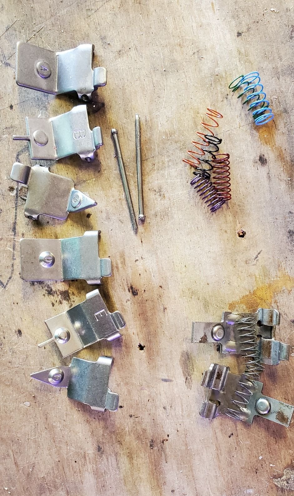

Still not getting it .
Here is what I have. On the left are the new weights. Upper right new springs. Lower right "old" weights and spring (there are other parts not in the photo, but these are all the inner weights).
The new weights are labeled A to F. All of the weights are, well different weights. So is the idea that I start with, say weight "C" and weight "D", go drive it and see what I think, then try a different set of weights?
I'm thinking that the weights should be the same weight on both sides, but that's not doable with what came in the kit.

Old Mar 16, 2022 | 02:28 PM
Greg in France's Avatar
Posts: 14,607
Likes: 10,802
From: France
This discussion should help. You do not need the same weight or spring on each side, but you will probably have to change the weights and springs on each side.
