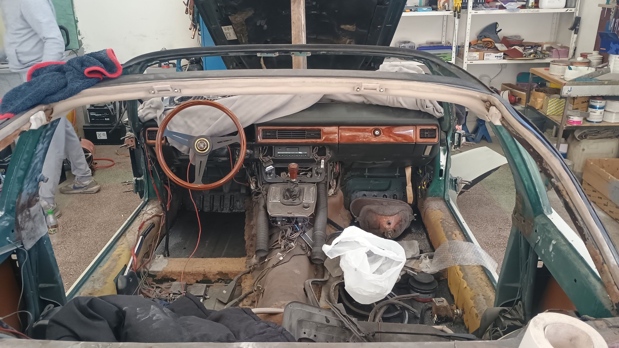

Hello, I restored the wooden elements. Actually, the hardest part was removing the old coating. I removed it with hot air, but I have experience with that. If you don't have experience, you have to sand. Then I used a two-component epoxy varnish. I applied four coats, sanding between coats with wet sandpaper from 400 to 3,500. Then I polished with epoxy resin paste.
