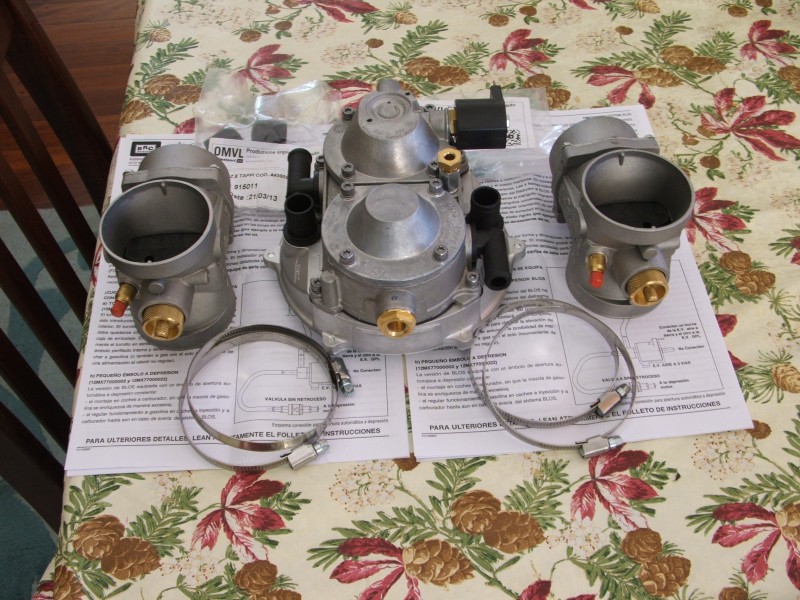

My LPG carbs and vaporizer arrived today (very exciting)
Iam using the BLOS carbs and OMVL R90 high output vaporizer from Poland.
He is very helpful and good to deal with.
The BLOS carbs look and work like SUs and are more efficient than the ring mixers.
This project is probably going to upset the purists, but it is something I want to do.
Here is a photo of the carbs and vaporizer.

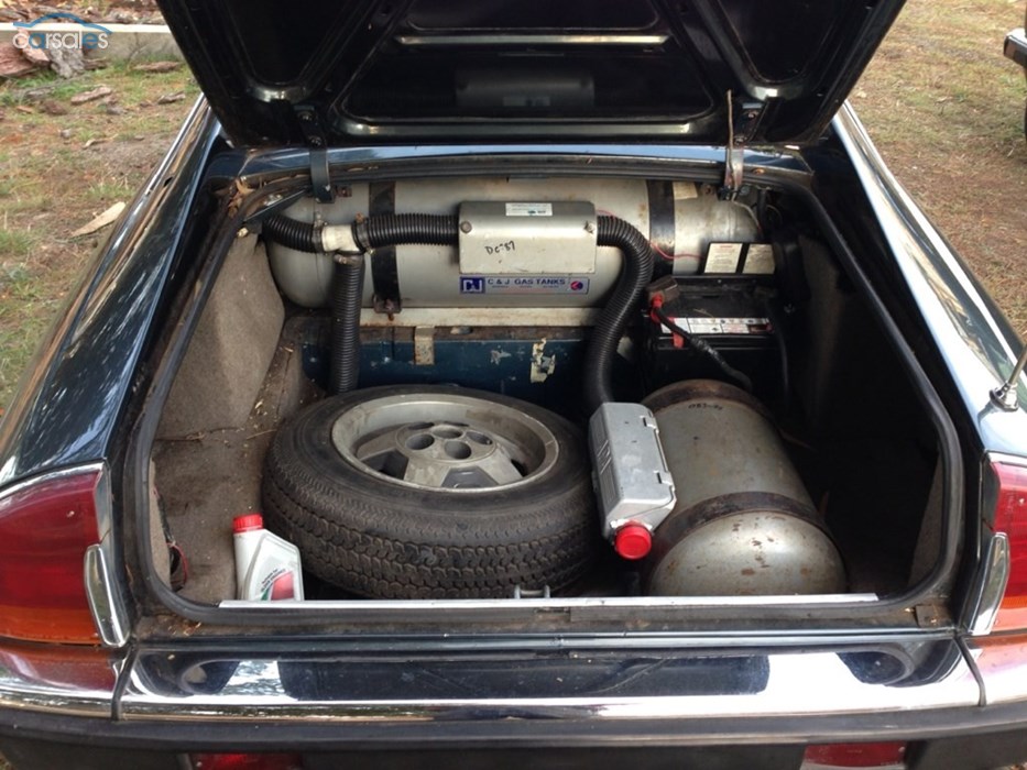

Another photo of an XJS for sale in Melbourne fitted with LPG. But I wouldn't use the second tank.
