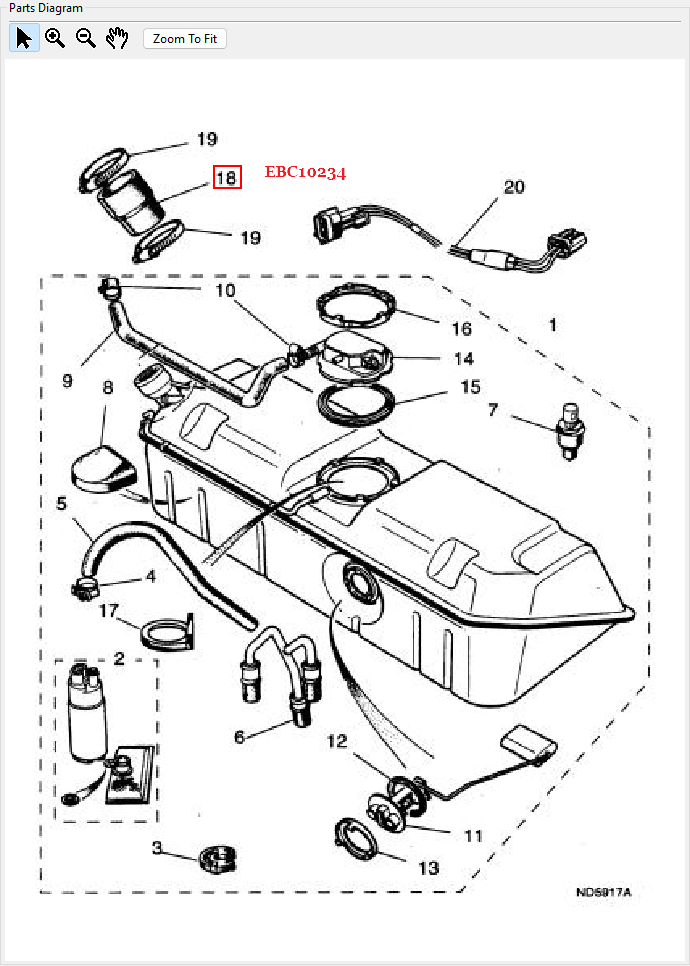

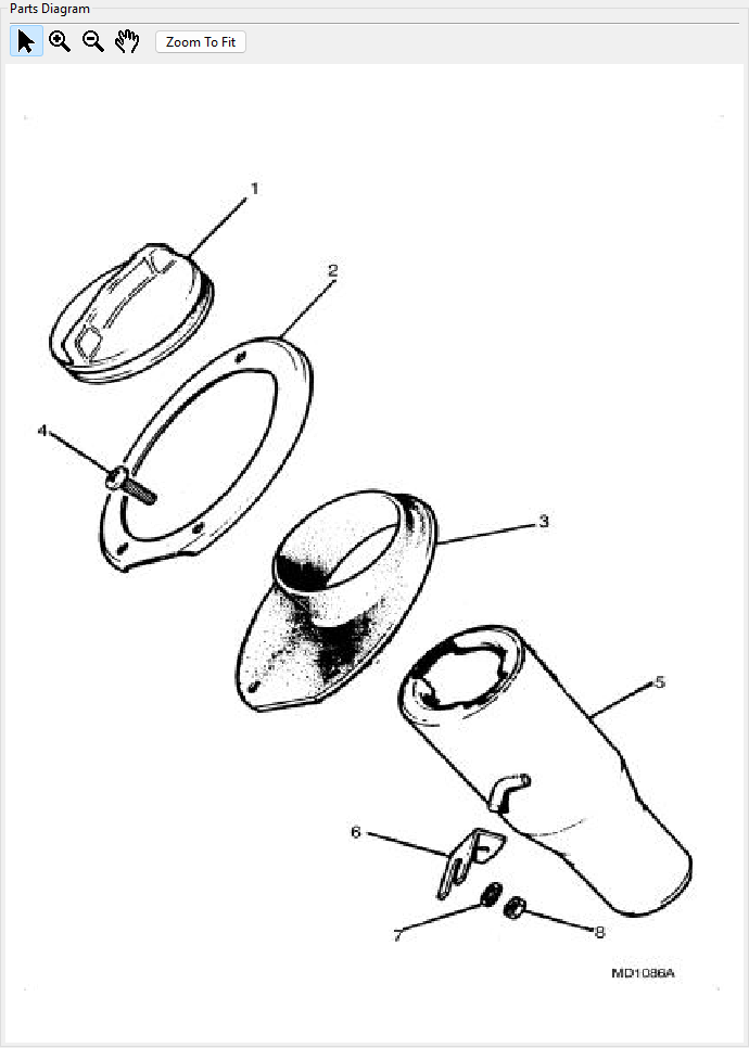

WOW! Yep.. wow. *Just checks back in* That tank is rough. I'd imagine the best way to clean it is to cap the exits and fill it with a phosphoric acid solution, pressure wash, drain, fill with cheap vodka, splash it around, drain and let it dry.... It's reasonable to worry about your lines, and if you've got the ability to replace / re-engineer them & proper crimpers.. why not? This might be a chance to to try out that NiCopp (works for fuel too in the right dia), or SS though...have fun bending that....
Per BenKenobie on these forums, there apparently IS such thing as counterfeit Kunifer/NiCopp that can rust. Check what you get with a magnet. It shouldn't' stick (despite the nickel and slight Fe). I just double checked the spare bit I have with a neodymium magnet and nope.. nada.. no stick.
You could also try to blow out the existing lines and recirculate EvapoRust through them for a few days (transfer pump + bucket) then blow out with vodka.
I still have to pull the tank on my X300 myself.... been putting it off.
~PK.
From JPart - Illustrations:

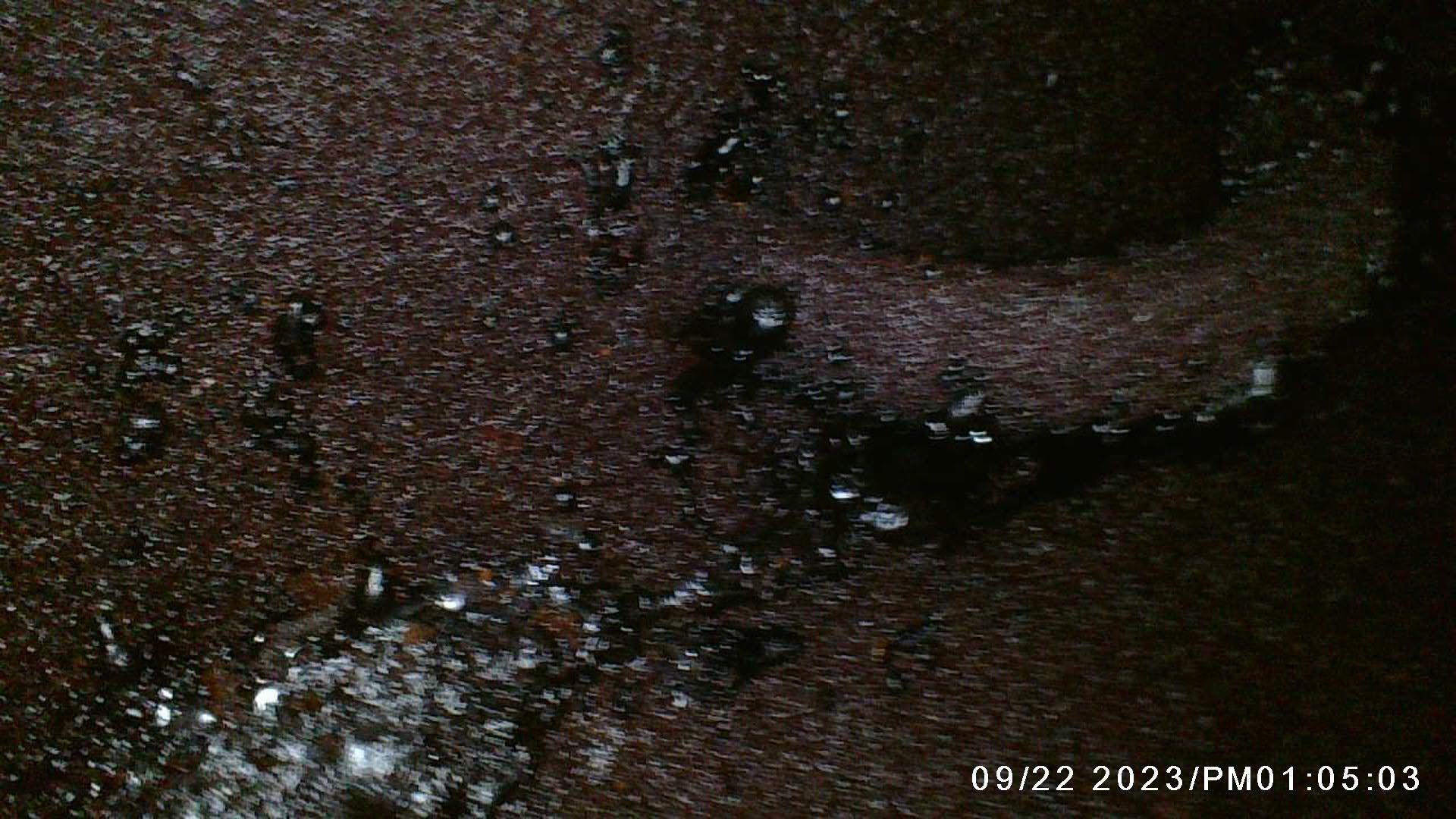

I hadn't spotted that picture - way to go - I had the same stuff in my old tank, tried everything including enough caustic to cause the water in the tank to boil - nah not sketchy at all - nope not sketchy it was terrifying ... and even after a week soaking that stuff persisted.
This was the inside of mine taken with a borescope - the pipe in the image is the tank outlet at the bottom
Nearest I can tell is that it is actually something like the plague of diesels, it is dead bacteria and what is left when petrol is degraded and consumed by said bacteria, don't want to be a purveyor of doom but check your swirl tank (does your model even have one - maybe not), mine was also full, I removed the fuel drain and nothing drained, just started dripping a gloopy black tar that after a while open to atmosphere was rock hard. I got the stuff out of the swirl tank with a spray painters tool called 'gun wash' - it is nasty stuff, not environmentally friendly and certainly not people friendly but it will disolve pretty much anything it contacts, there was no way I was tipping 10 gallons of the stuff in a petrol tank - that's just a disposal and handling nightmare.
Scary part is that when I found this my car had been parked only 3 years though it had been sat for 15 years when I got it. I think some of these 'things' are why many revive an old classic and end up chasing countless little issues that never end because the issue is never truly fixed.
Needless to say I have replaced the tank and every single fuel line - my injectors were also not in the best of health ... the rabbit hole goes deep Alice ...

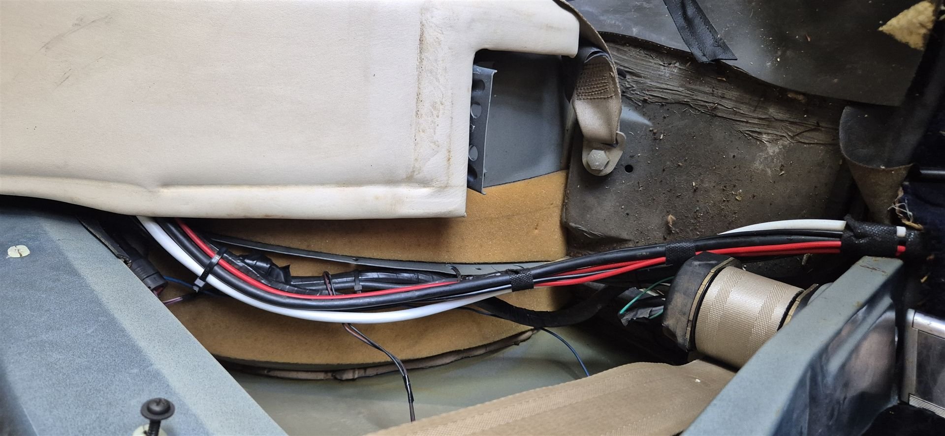

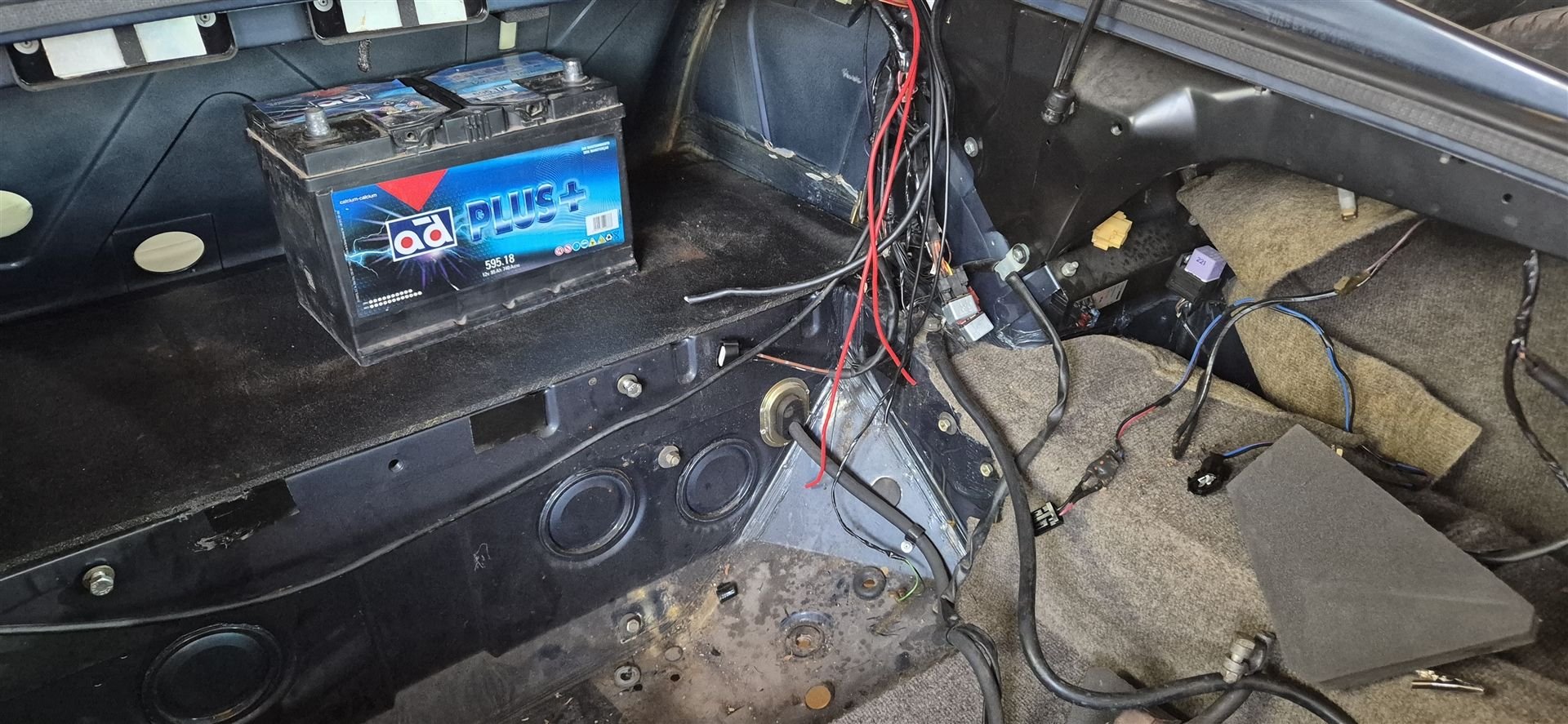

After few days of working on customer cars, had time to work on Saphira today again.
First I decided to relocate battery as well to cleanup the boot area. So my battery will now come on the passenger side, being protected with wall and firewall from two sides, fuse panel from other side and a custom mount from the 4th side.
I pulled also 2 6mm² red and black wires, 12x wire for signal purposes, and white wire with 3x 1,5mm² inside for various other things all the way from back where first fuse/relay box will be, to the front foot-well where the second fuse box will be.
Main battery wire gets also a fuse now.
Here come out all the new wires. I might not need that much, but like to have it in case I have to and not need to open it in the future. I fixed most of the original harness issues which were obvious, but there are still way too many mystery wires and color changes, some looking even like factory, so not sure how much I will be reusing or redoing. Once the engine runs and I will start reassembling it, i will decide.
Pulled out the rear seat as well and routed new cables behind it, also used the chance to clean it up a bit and remove the aftermarket wires for audio and probably reverse camera which were there.
