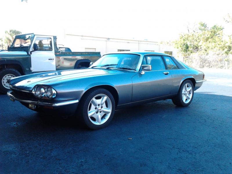

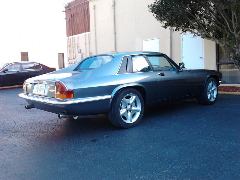

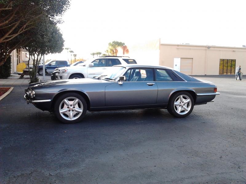

Can you tell us how exactly you did that?
Are these just the top covers, or there is some slim bumper frame under you fabricated?
BTW, it looks lovely!
Are these '97 XK8 rims?
I wish I had taken some pictures, but once you examine how the blades are fastened to the car, you'll see how it works. This was fairly simple, but does require welding.
The chrome blades on the pre-facelift HE are separate from the actual bumper. If you take two sets of blades and lay them on top of each other, you see how they can be mated to form a single slim bumper. To do this mod, you'll need an extra set of blades from another car. Beware that there seem to be some minor manufacturing differences from early HE to later, so try to get extra blades from a car that's about the same year as yours.
Remove the front and rear blades from the car and disassemble the sides from the centers.
On the rear side blades, the upper set of sides will need to have the rubber overhang mounting studs removed and the mounts trimmed back, leaving the body mounting bracket intact. The rear lower side blades will need everything removed entirely. On the rear upper center blade there are two mounting studs and the sides are bolted from inside the trunk to the upper side blade. ON the rear lower center, remove the stud mounting bracket completely.
On the front side blades, remove the mounting points for the rubber overhangs on one set of blades, but leave the studs that mount the upper blade to the body. You'll end up with a set of lower blades with nothing, and a set of upper blades with studs.
Now, when you lay the upper and lower pieces together you'll see where the front edges of each blade folds back under. Clamp the two pieces together and weld the inside edges of those folds. That will hold them together and will not damage the chrome. If you tweak the blades carefully and clamp well, the seam isn't very apparent.
Once you have the three front and three rear sections welded, you can bolt them together into a complete bumper assembly.
You need to clearance the bottom blades a little to get access to the studs you left on the uppers. On the outer front blades, I used a Dremel to grind away enough to be able to get a socket on the nuts. On the rear center blade I used a hole saw to cut access holes for the two studs. The outer rear blades are bolted on from the inside of the trunk and you don't need to do anything for them.
Clean up your welds, prime and paint the insides, and your assemblies are complete and ready to mount.
On the front, you don't really need to do anything with the old bumper mounting brackets. I covered mine with the foglights. I reused the old turn signals by opening up the valance panel.
On the rear, the shock mounting tubes looked really ugly and there's an odd reinforcement panel fitted over the valance. I used a spot weld cutter to separate the panel and cut the tubes off with a sawzall. I used some of the old sheet metal to weld a patch over the holes where the tubing came out. Grind smooth, a little filler, sand and ready to paint.
It takes a couple of hands to get these installed and it's a snug fit over the fender-to-quarter seam. Use some tape to protect your paint. Once installed on the car you can adjust them and then tighten the mounting nuts on the studs.
These things end up being purely cosmetic. Any little prang will cause damage, so be sure you don't bump anything!
