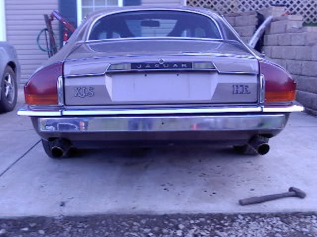

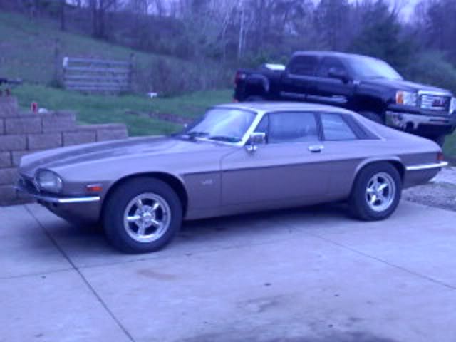

just wanted to say that i did the bumper delete, but left the chrome blades. im cutting the protruding brackets and bolts from the blades so that it blends with the car better. i didnt like the look of the rear with no bumper due to the gas shock holes, and i cant afford the time or patience it takes to cut them, bondo them, and paint them. so instead i hacked up the gas shocks, took the black rubber off my rear bumper, and JB Welded the gas shocks at the bottom of their travel so that the old bumper sits flush with the bumper blade. it looks MUCH better. im in the process of polishing the aluminum bumper. i might paint it but im not sure.
i highly recommend this mod. the only thing keeping me from loving it is that i dont have a front spoiler. still looking for it.
ill take pics as soon as i get the bumper polished up and looking good.

heres a good pic. i cut the gas struts right before the adjustment bolt threads through the end of the shock. then i was able to adjust them accordingly. i polished the aluminum bumper with a brown bar and a grinder w/buffing wheel. i just cant put into words how much better this car looks.
.................................................. ................................................^ my tool of choice.^
