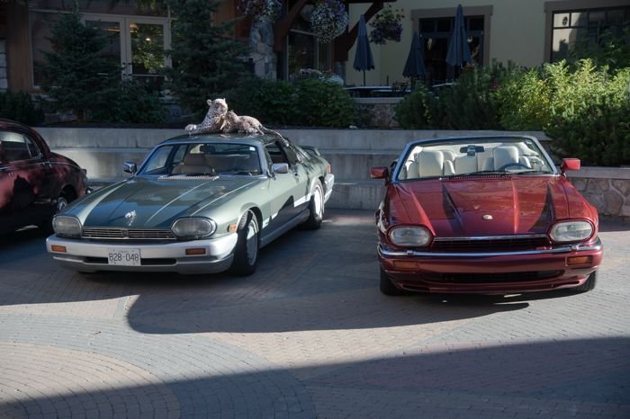

One thing to be aware of is the later cars have a different hood (bonnet) with a taller "power bulge" than the earlier cars. I don't know if the 6 cylinder will fit under the lower bulge. Low bulge on the green car, tall on the red car.
