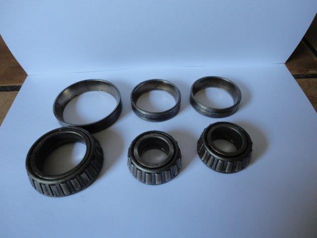

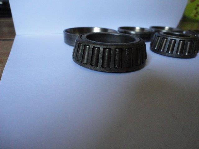

Default Was the Wheel Bearings
It was the wheel bearings. Right side had about .011 play. Left side was within limits at .003.
Photos show spalling of rollers and the conical races. Left side inner bearing had no indication of damage, but I replaced it anyway. After replacing bearings, vibration was gone.
