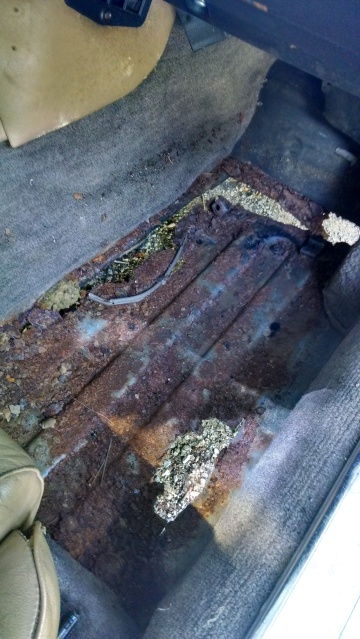

Hello, all. I've fixed the stuck passenger door only find that my car has a serious case of rust.
I have the supplies to cut it out and weld everything. I could part the car out and get my money back... But never!
My two options are to buy a new floor pan, or fabricate my own from similar gauge sheet metal. Any suggestions? My car is a 1989 XJS

It can probably be fixed with patch panels. I've seen worse, but it may be from heater core or other problems...

I bought this floor pan from SNG Barratt. It's a sturdy, quality piece that also include about half the transmission tunnel, and is already primed:
SNG Barratt - XJS RH Floor Pan
***EDIT***
I forgot to mention that Jaguarforum members get a 10% discount. See this thread for details:
https://www.jaguarforums.com/forum/n...tt-usa-108134/

Thanks a million! I still need to get her up on a lift so I can do a more thorough rust check and everything. I now hate sunroofs. Spend extra money on a feature that'll rust your car out later xD
