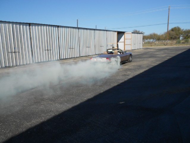

Old Jun 3, 2014 | 02:26 PM
  #28
ronbros's Avatar
Joined: Jul 2010
Posts: 7,362
Likes: 1,241
apic of mine 78 Xjs 5.3L V12, also posted elsewhere, burnouts no problem, its ALL about the total gearing arraingments.

Old Jun 4, 2014 | 01:42 PM
  #29
SeanPeterLynch's Avatar
Posts: 159
Likes: 22
From: NYC
Do you h ave stock gearing? How did you do this? 1st gear and break?
Old Jun 6, 2014 | 06:34 PM
  #30
ronbros's Avatar
Joined: Jul 2010
Posts: 7,362
Likes: 1,241
sean, had that same trans in for 20yrs ,700R4 built with kit, light weight,hi stall convertor.
3.73 gears, hi bias Dana LSD, aluminum drivshaft(light).
of course the car only weighs 3360lbs (actual on a calibrated scale).
