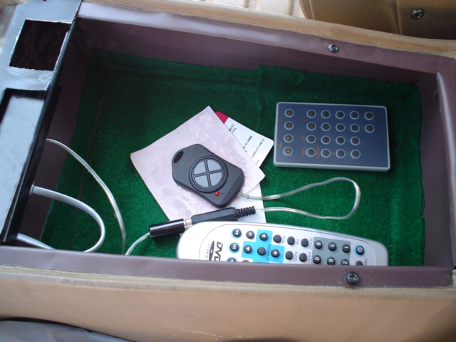

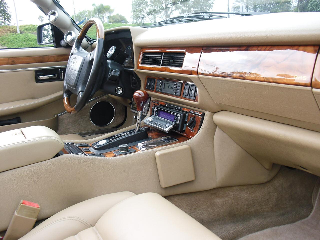

Yes, the X300 lid is longer, so I kind'a split the difference protruding, both, front and rear with the help of the generous, longitudinally slotted holes on the hinge that let you slide it front and back until you're compfy with it. The rear protruding can hardly be seen and in the front I did not work on modifying the latch because I needed a good, strong security lock, as the '94 XJS has no locking storage other than the trunk, so I can walk away from the car leaving the top down instead of moving valuables to the trunk every time. It has a large metal striker that operates in that square hole that you see in the picture and you'd need to destroy it open to force entry. Otherwise, it closes just by gravity or with my right arm always on top of it.
The new lid ends in the front at a 45 deg angle (pic from the right), which is perfect to access (with my fingers) the controls I have under the front lip of the lid (currently five items there); the knob is subwoofer control. That pic is from back, when I had moved the trip computer to the ski slope...
Notice how I increased the box's storage volume to fit more valuables in it. Makes a big difference.

Wow Reinaldo there's a lot of modifications going on on your center console!!
Question though, why do you have two trip computers? Also what did you do with your convertible top switch?

Allan,
It's only one trip computer that I had previously relocated to the near end of the ski slope to make room for the sound processor control/display, so it would be right above the radio. I have concluded that the trip computer can, or better should, go back to its original location without losing sight or control of the sound processor operation, so I just swapped the units.
The '94 XJS has a "vacant" switch right next to the "Hazard switch", left of the steering column. That's where I moved the C.T. switch.
What goes on at the front lip of the center console box (more nowadays than the picture shows):
- The red push button (momentary switch) is the ECU reset (which I need to protect).
- The green mini toggle is the "Accy" switch (separate from the start button).
- The knob is for the subwoofer amp, in the trunk.
- There's a new "test" mini toggle for the start/stop system, just in case it ever fails. The thickness of the wires I had to cut to incorporate my system made me a little overly cautious...
