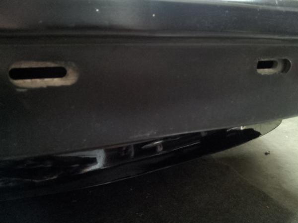

I'm replacing the sealed beams on my '87 XJ-S V12 with some euro lights, so I've got the front jacked up to run the wiring and do some other stuff.
One of the "other stuff" things is to put a front license plate on. Imagine my surprise when I reach behind the front bumper and find that there are NO HOLES in the back of the bumper with which to reach in and tighten the license plate nuts.
Of course this is all venting...but just out of curiosity, how did Jaguar intend for someone to mount a front license plate without either removing the bumper, drilling holes into the back of it, or using really big/strong sheet metal screws?
Or...am I missing something really obvious???

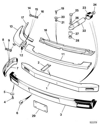

Yes you have to drill holes in the bumper. Jag supplied a front license plate bracket/reinforcement with every car in the US. It was dealer fitted depending on local state regulations.
This diagram shows the part (#29)
Cheers,
Allan

Interesting, thanks for sharing it.
We're not required to have front plates in Indiana, so maybe it is from "here" and the dealer didn't bother/need to mount it. In a way though I'm still missing the point. My bumper does have the two slotted holes that match up with the top holes on a license plate, but even if the reinforcement plate were installed, there is still no way to get behind it to undo the top bolts, unless maybe the reinforcement plate came with plastic "nuts" permanently mounted in it (there is a name for them, but I don't know it) and using plastic bolts or screws was how the plate was supposed to be mounted?

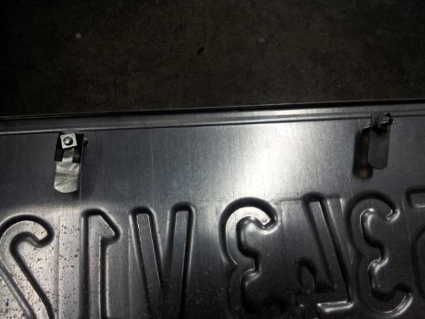

@John
Yes, it's not the best design by any means.
I made up some little metal "flaps" or "ears" and, when used with long thin bolts allow me to hook my plate on. The flaps go between the metal part of the bumper and the rubber outside part.
Hopefully these pictures help explain what I'm talking about
My car didn't have a front plate on it when I got it so I cobbled this together myself.
Has been fine for the past 3 years
Attached Thumbnails You've got to be kidding me...-sarc-4188-albums-posts-2-7409-picture-20130929-091653-20665.jpg   You've got to be kidding me...-sarc-4188-albums-posts-2-7409-picture-20130929-091809-20666.jpg   You've got to be kidding me...-sarc-4188-albums-posts-2-7409-picture-20130929-091832-20667.jpg

Thanks guys. I did pick up a couple of nylon "nuts" at the store today, so I'll give those a try before I start drilling through the back of the bumper. Lacking success there I'll give Sarc's idea a go.
