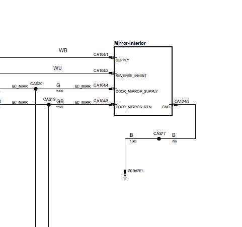

This may sound a little unusual however I was wondering if anyone knew or could direct me to where I can find out the order of wires that go into the female harness that plugs into the rear view mirror.
Unfortunately I purchased a car that was missing the mirror and the harness was cut off.
I now have a replacement mirror but am missing the female harness and have no idea which wire plugs into which on the mirror.

Assuming you have the new shape (06 on XK) then the two items attached should be the connector and circuit for the mirror.
