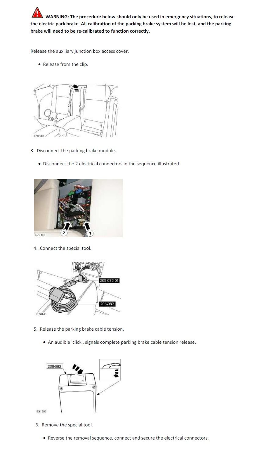

Hello all,
i'm getting an open circuit fault on the EPB on a '07 XK convertible. I suspect the issue might be with the wire harness. I know the EPB module is somewhere in between the rear seats near the fuse box, but I'm not sure where. Any tips would be highly appreciated!

Surprisingly no photos in the workshop manual but it is behind the back seat rest. Gray connector, 24 pin - guessing not too many of those back there.

Came across this when looking for something else ........
......... at least gives a related photo of where to look.

From the other thread, there's a harness over one of the half shafts that could cause the issue.
It's located here:
