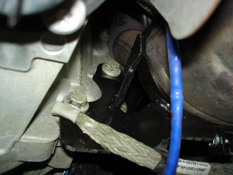

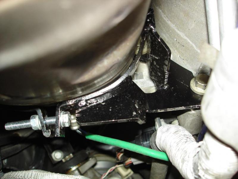

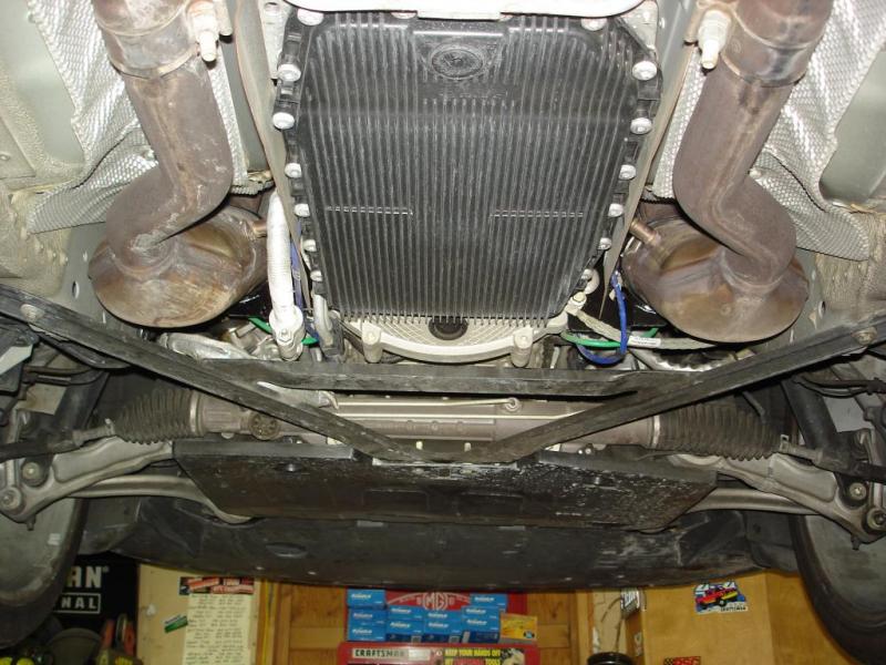

Hey Guys,
I just purchased my first Jag Nov 23rd, and thanks to this forum I found out about the dreaded drone at 1250 rpm's. The dealer installed the Catalytic converter brackets and the noise is GONE. Others have stated that the fix merely moves the sound to a different range of rpm's, but thats not the case with my Jag. A few have wondered if they could fabricate the brackets but I think that would be fairly difficult, Anyway I also thought I would post a few pics for those that asked.

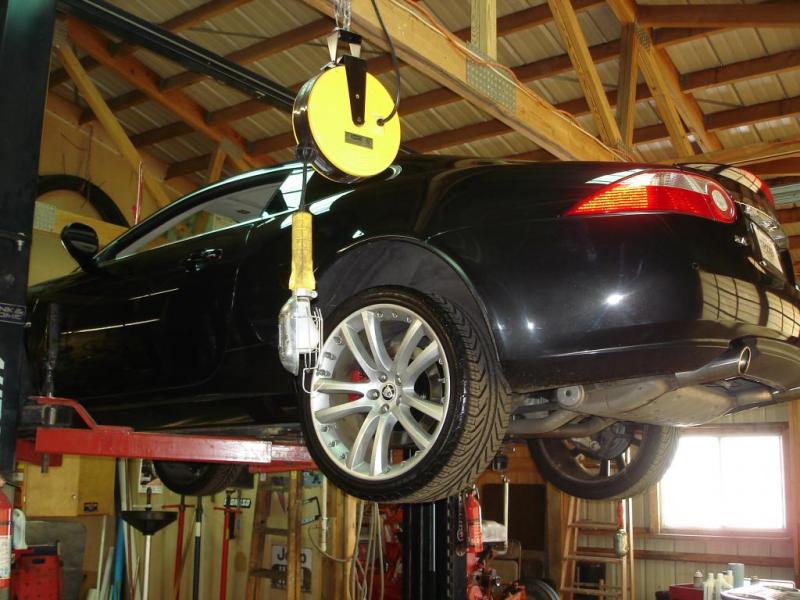

I put her up on my lift to get a better look.
The brackets are at the front of the Cats both are black.
Drivers side
Passengers side
Notice that both side use two bolts on the transmission to secure them.

I'm jealous of your awesome garage!!!

Very clever solution; thus the Engine, transmission and exhaust are all still rubber mounted.
But brackets at $280 apiece must have been made by a Swiss Dental Firm!
I think I'll just change gear......................or buy some gold!

I wonder if there is any problem of heat conduction from the cats to the transmission? Or is there some sort of insulator on the band part of the bracket? No need to be heating the tranny fluid any more than necessary.
