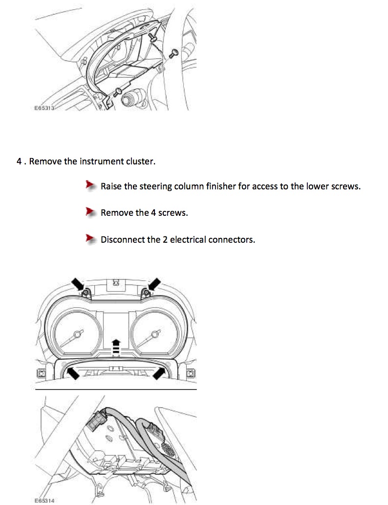

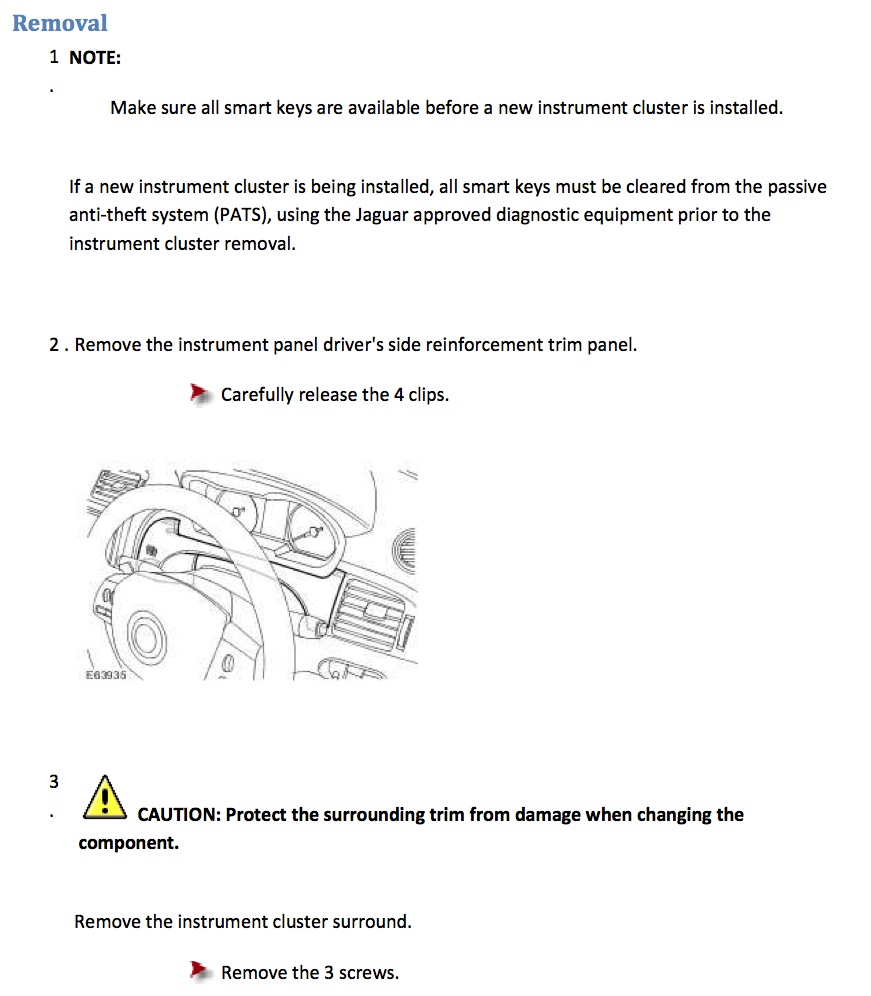

If you're going to do that sort of work, you need a copy of the Workshop Manual - have a look on eBay, where you'll find CDs on sale.
In the meantime, this should help:
07 XK Instrument cluster-screen-shot-2014-03-26-17.01.51.jpg07 XK Instrument cluster-screen-shot-2014-03-26-17.02.17.jpg
