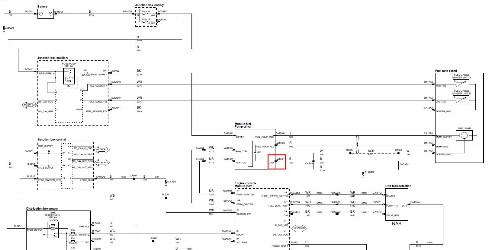

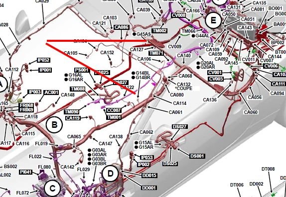

Might want to check grounds and wiring:

This is beyond my technical knowledge. All I know is that the fuel pump should fire up when the ignition is switched on, to pressurise the fuel system, and then will turn off until the engine is cranked. So, I assume you're saying that if you turn on the ignition - i.e. you press the start button without pressing the brake - then fuel pressure doesn't come up at that point. Can you rig something to show when the pump runs, such as a multimeter?
