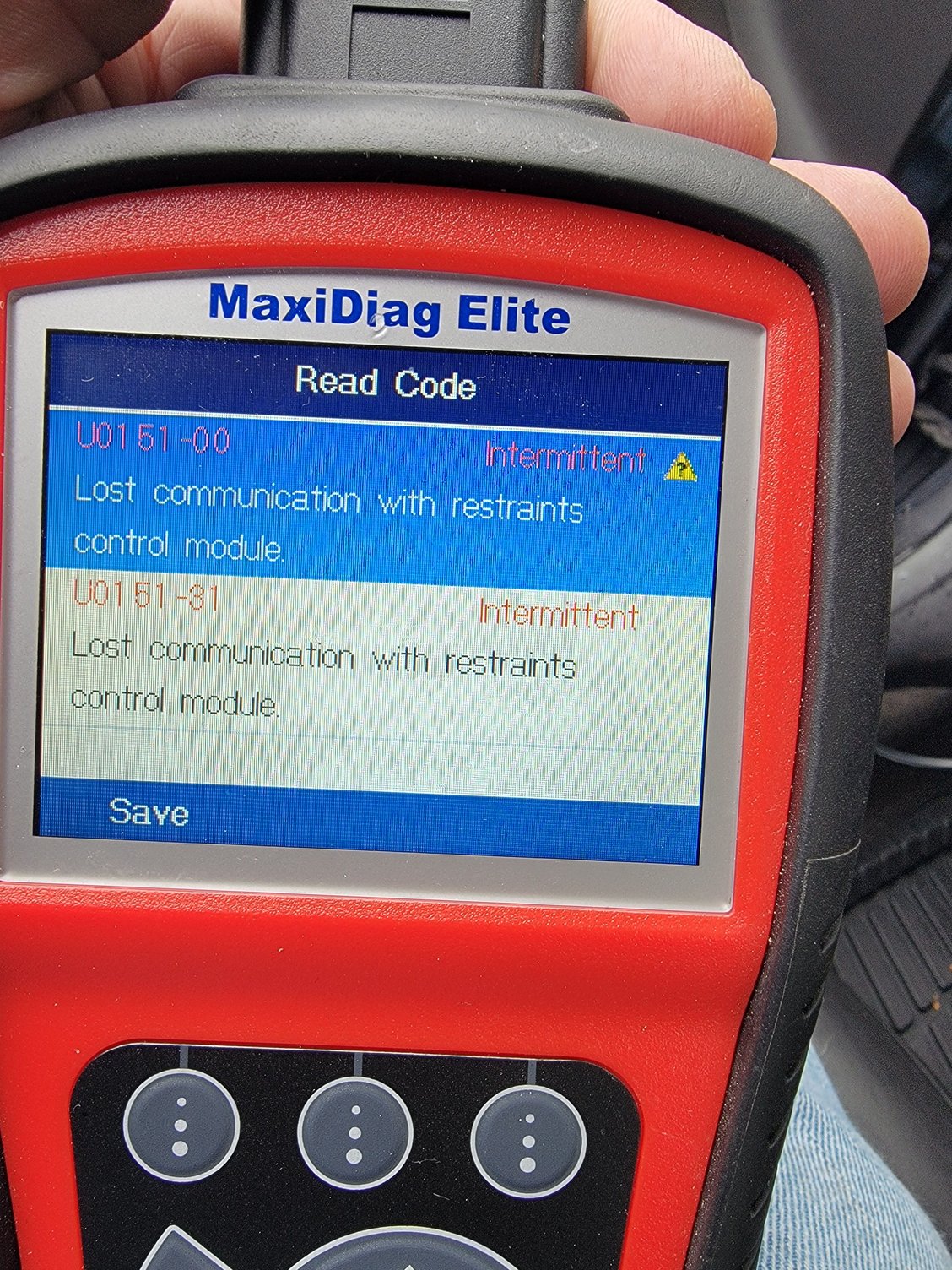

I do get one reoccuring code after resets and erasing cades... U0151-00 and U0151-31 Lost communications with restraints module...
I believe it could be related. The module has the ability to disrupt the fuel pump control module. It is what is now the inertia switch so to speak.
That HAS to be diagnostically significant.
