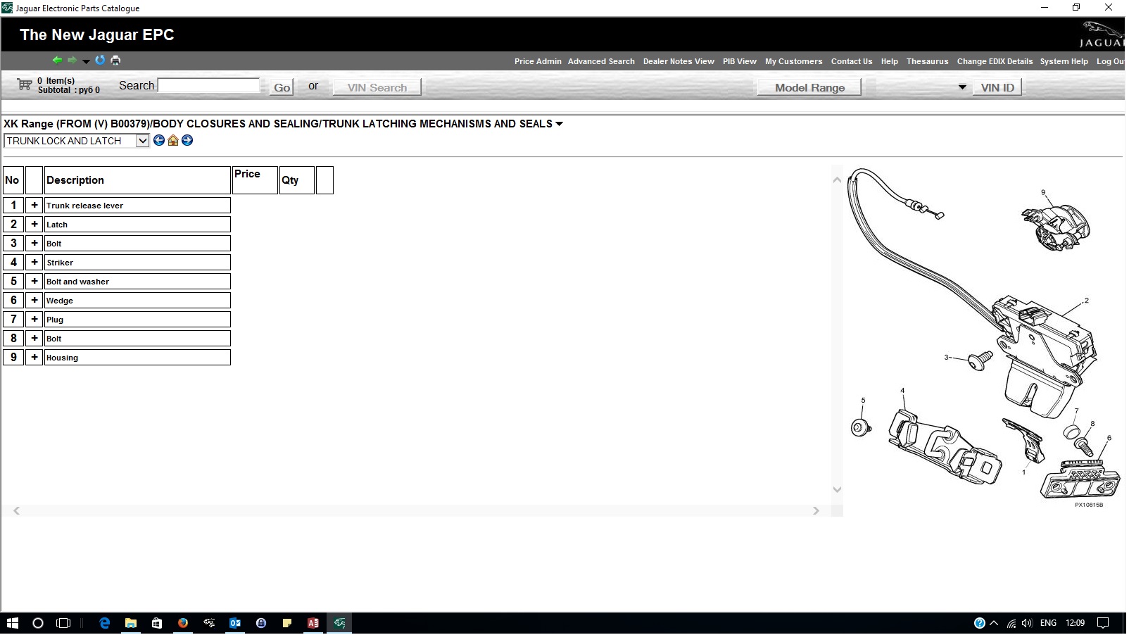

If the electrical latch release has failed, the mechanical cable link to the keyway should still work.
Here's the relevant page from the Parts Catalogue:

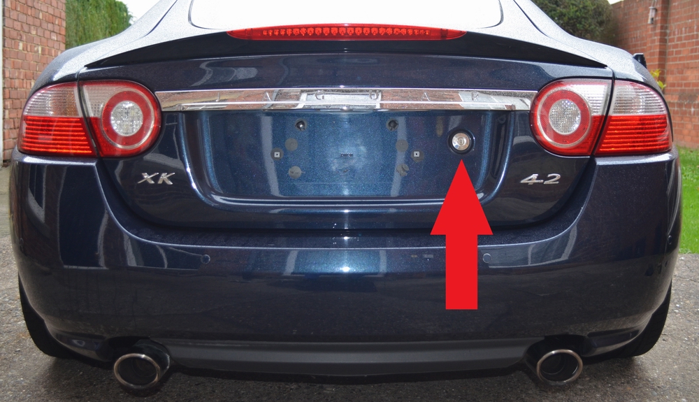

Likes: 17,009
Originally Posted by 1 of 19
Did not see a slot for blade. .....
Usually covered by our European standard registration plate.
Old Jan 24, 2017 | 10:14 AM
britannia's Avatar
Joined: Jul 2011
Posts: 665
Likes: 110
From: Federal Way,WA
Yep, sure is there! 9" to right of car centreline........... US '07 Coupe.

Yep right were it's supposed to be. Silly me. So the emergency release does pull out length ways and would be an easy snag if ever needed as an option. The car alarm did not like the blade as the car was locked, but I sure did. Latch just needed to be reset and is working fine now. "ker-thunk" I'm sure glade you all showed me the light before the wolf wandered out there and opened it. You know... then comes the "really" look.
