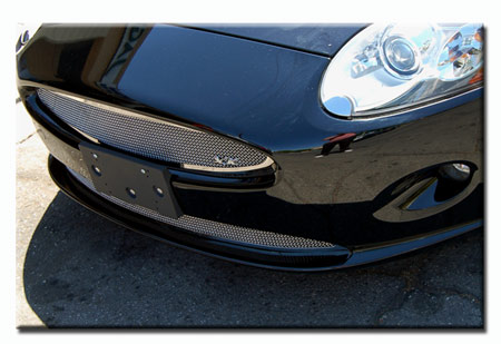

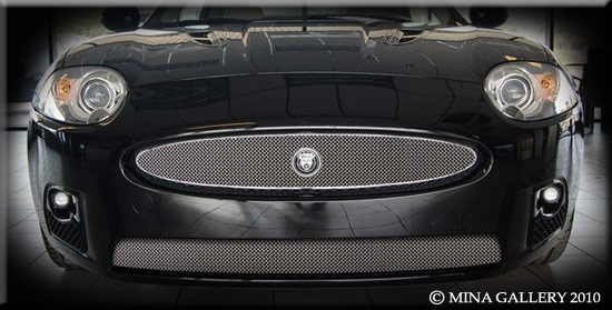

Mina Gallery offers two styles of woven stainless steel mesh grilles (upper and lower) for both XK and XKR (X150) models. The first is Aston Martin style and the second is OE style. They both have triple-plated chrome surrounds. They install without removing the bumper cover and simply screw on top of the OE grill using tiny SS screws. The SS mesh completely covers the OE plastic so you don't see it unless you're up close and really look for the OE grille. Clever. But you still have to remove the Growler from the old grille. The grilles are also available in black mesh with a black surround.
Unfortunately, Mina doesn't offer a SS grille to cover the painted plastic mesh area under the lights on the 2007-2009 XKR bumpers, which would complete the look.
The Aston-style set (upper and lower) is $450 and the OE-style set is $300.
Here's the link: Jaguar XK8 & XKR Mesh Grille, Spoiler, Headlight Bulbs for Jaguar XK8 XKR Then click on the style and model (XK or XKR) link.
Aston-style on an XK: Note it has no center Growler.
OEM Style on an XKR: With the center Growler.
I am not affiliated with Mina Gallery and don't have their grilles on my car, and am simply mentioning this for your information.

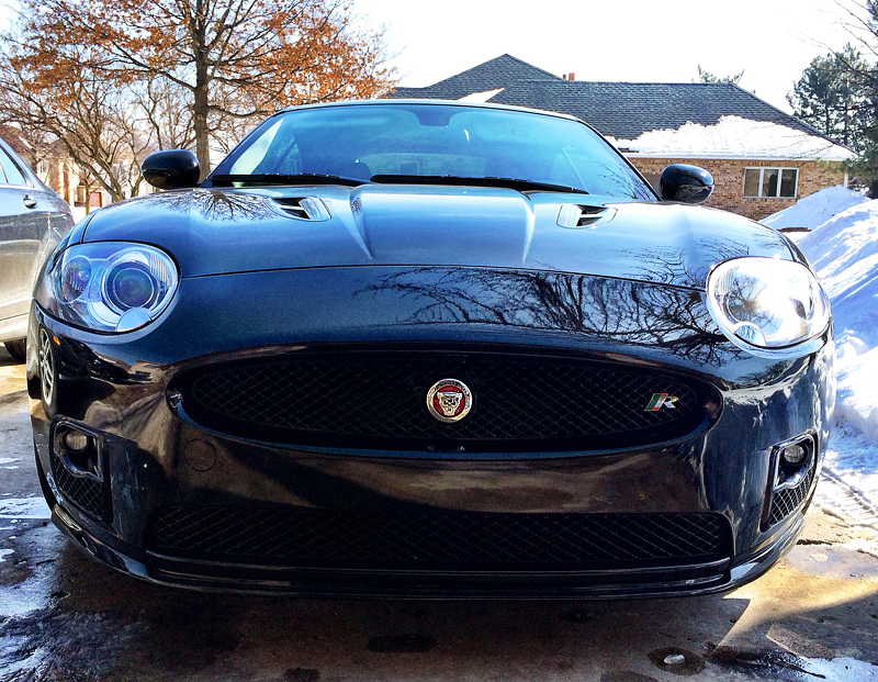

I was able to remove the emblem without removing the grill. I carefully pry off the emblem with a flat head screw driver. Then there's a back cushion behind the emblem that I then also carefully pried off. This leave just the chrome bezel still in place. I then replaced it with a red emblem. The red emblem needed modification to fit as the 07-09 xk/xkr emblems are smaller than the 2010+.
