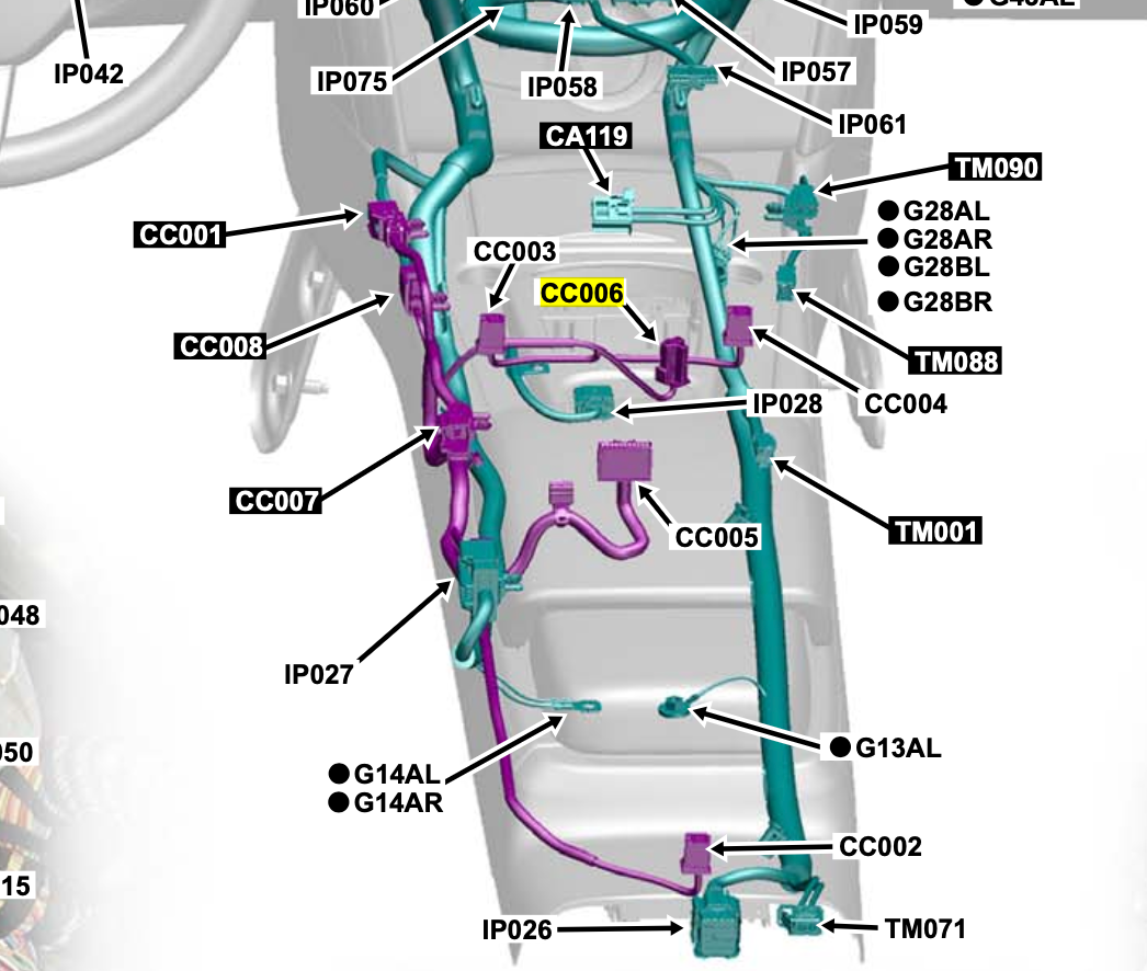

Well, I was able to do a lot of disassembly today and one reason the cigar lighter socket didn't work is probably because it wasn't hooked up to anything. I looked until nighfall overtook me but didn't see the connection. Now, if I can find the CC06 connector I can hook it up and see if I hit pay dirt.

CC006 is under the lighter and is the actual lighter connector -

Success! The right connector wasn't where it should be, but I found it over the side tucked into the sidewall of the center console. I pulled it out and it works! I have one working 12 volt socket now. I'll leave the accessory socket in the glove box for another day.
