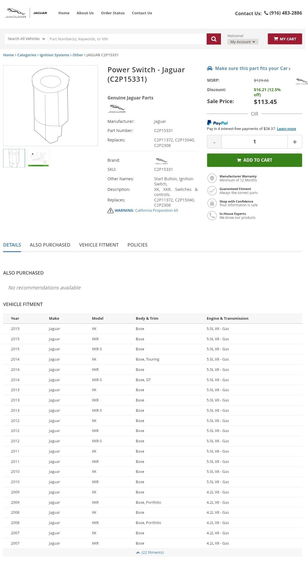

The current part number is C2P15331 and replaces part numbers C2P11372, C2P15040,& C2P2308, I haven't been able to locate anything in the black and white scheme.

It does look very similar but According to those EBAY sites:
Compatible with:
for Jaguar for XJ for XJL for XJR 2014-2019 not reference XK150 range.
I checked a couple other Jaguar Parts sites and they indicate this part # is not compatible with the 13XK.
Might you have some other insight that says it will work in the XK also.
I will probable ask the Ebay supplier also.
The price isn't very high so it may be worth the try.
I had it apart once and from my recall it looks similar
Appreciate the help.

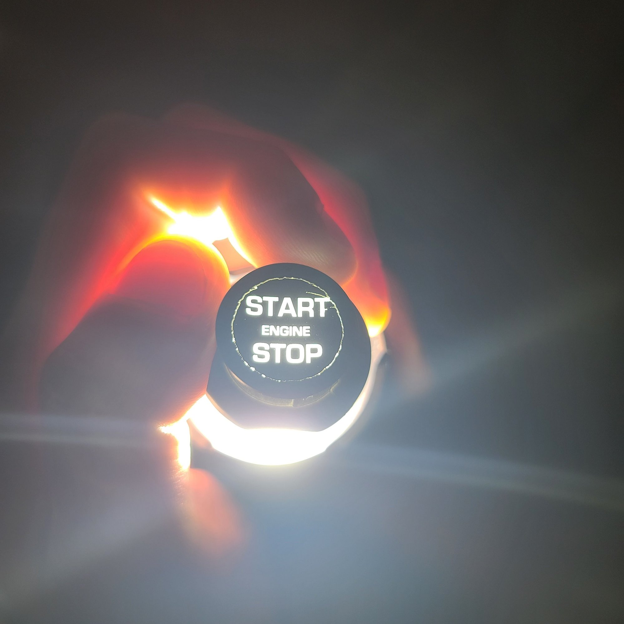

I saved my old button, if anyone is interested. Make an offer.
You'll be able to see where it was cracked when it illuminates, but someone might be able to get creative with black paint on the inside perimeter to block light from coming through the cracks.
It could also be a candidate for taking measurements to 3D print a replacement button. Some time smoothing an ABS print with acetone, filler primer, sanding, and a Stop/Start sticker would make a passable reproduction. It wouldn't illuminate, but maybe that's not a big deal to everyone.
I have a feeling that printing in white, using a Cricut to create the START ENGINE STOP lettering to mask off, and painting black matte could be a method to have illumination working. It would require some meticulous work, though. A job for model makers and precision hobbyists.
Porsche guys do similar things for window buttons and labels, so it's definitely possible.
If someone wanted to take on that initiative, I will send them the button for the cost of shipping it, with the understanding that they would create the CAD model for DIY printing.

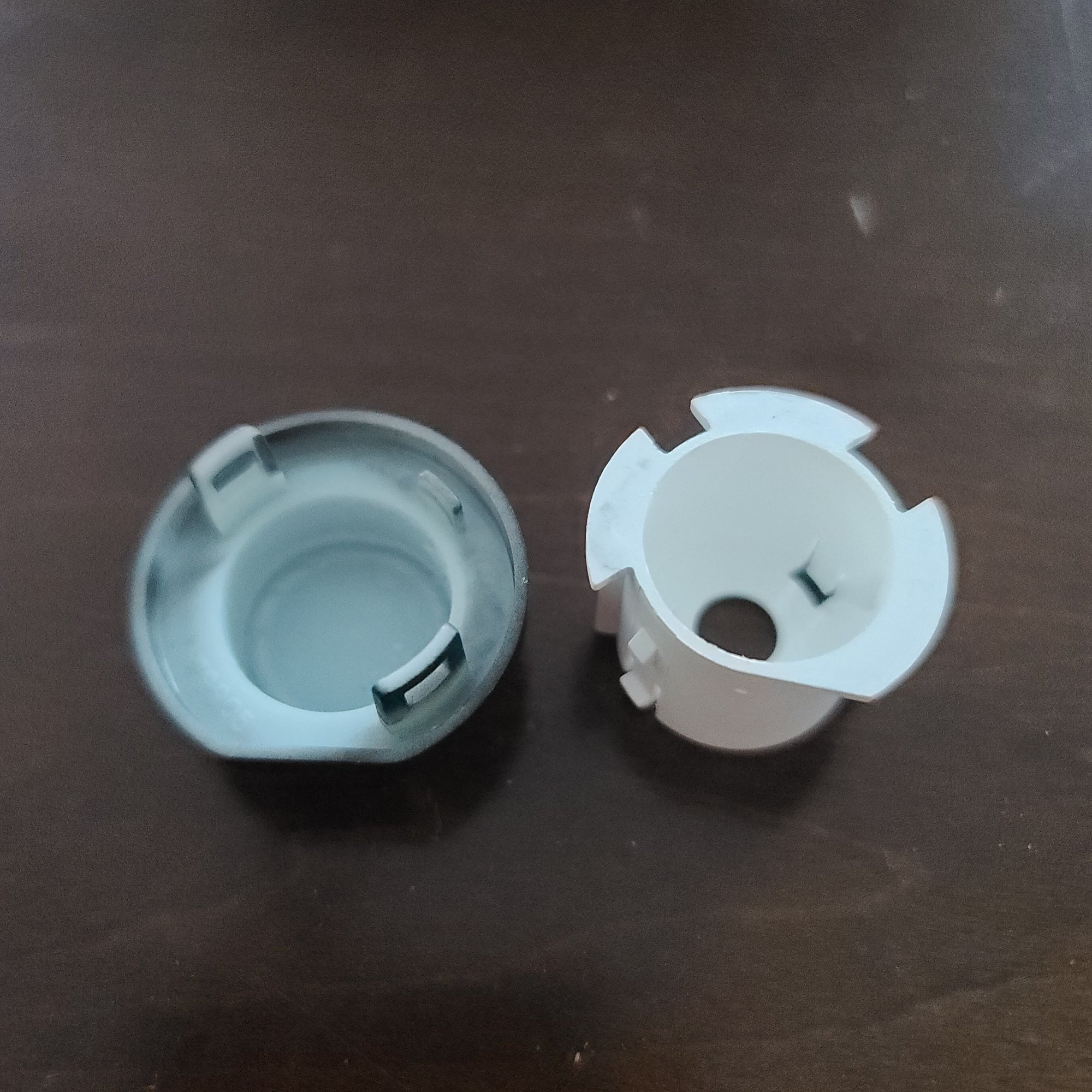

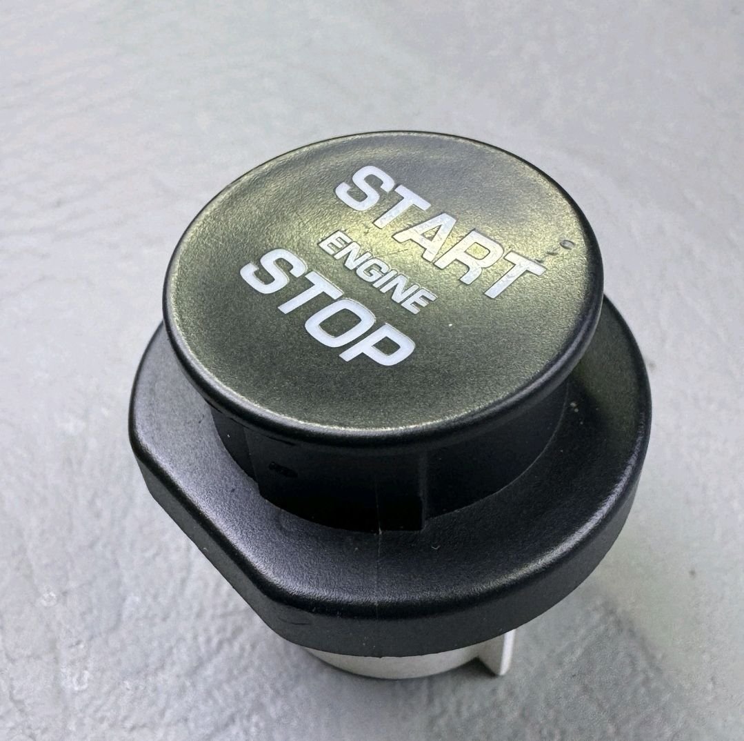

As of right now using this metal/rhinestone button with double stick tape, really durable and relatively decent looking. Have been using it for a couple years now since I never could find a replacement. Works great but gets surprisingly hot if parked in sunlight.
From Amazon, LECART BLING PUSHBUTTON I took a chance on the size and it fitted up pretty good. Its solid metal so you won't see the light.
So it looks like I'll be sticking with this for a while unless I get lucky to fine a used one and at that it would only be time before would crack up.
Metal/Rhinestone button stick on.  perfect fit
Button removed
Button removed
