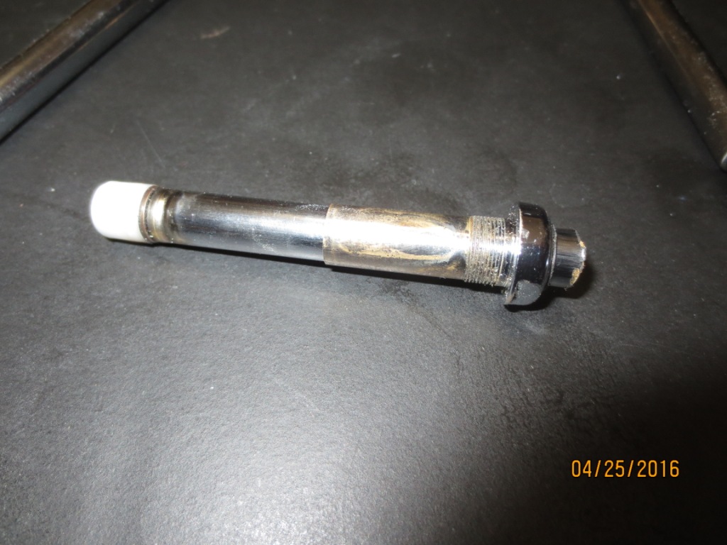

Picture attached is what end of my mast looked like vs. the ones described earlier in this thread.

Mine as shown in the picture has a nylon stop at the end and it is about 7.5mm in diameter. The one referred to in the instructions with a locking insert is 8.0mm shaft and will not fit into the ferrule on my XK.
Above being stated my car did have one replacement installed by Jaguar about 2 years ago ($500 - but you can see the price did not go down.) That is why I state that it is best to take it apart first to see what you have installed first.

OK, I obtained the new antenna from antennasrus.com and their part number is A008-DBC2200.
It is an exact replacement, installed easily and is working as expected. Teeth on the cable face rear of car when inserting new antenna cable.
