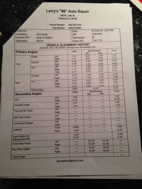

I probably missed them in my search but I didn't see any specs anywhere so I thought I would post these since I just had this done. Car was pulling a bit to the left with the steering wheel level. Now it rolls beautifully. Elmhurst Jaguar used this sub to do the work...Jac
