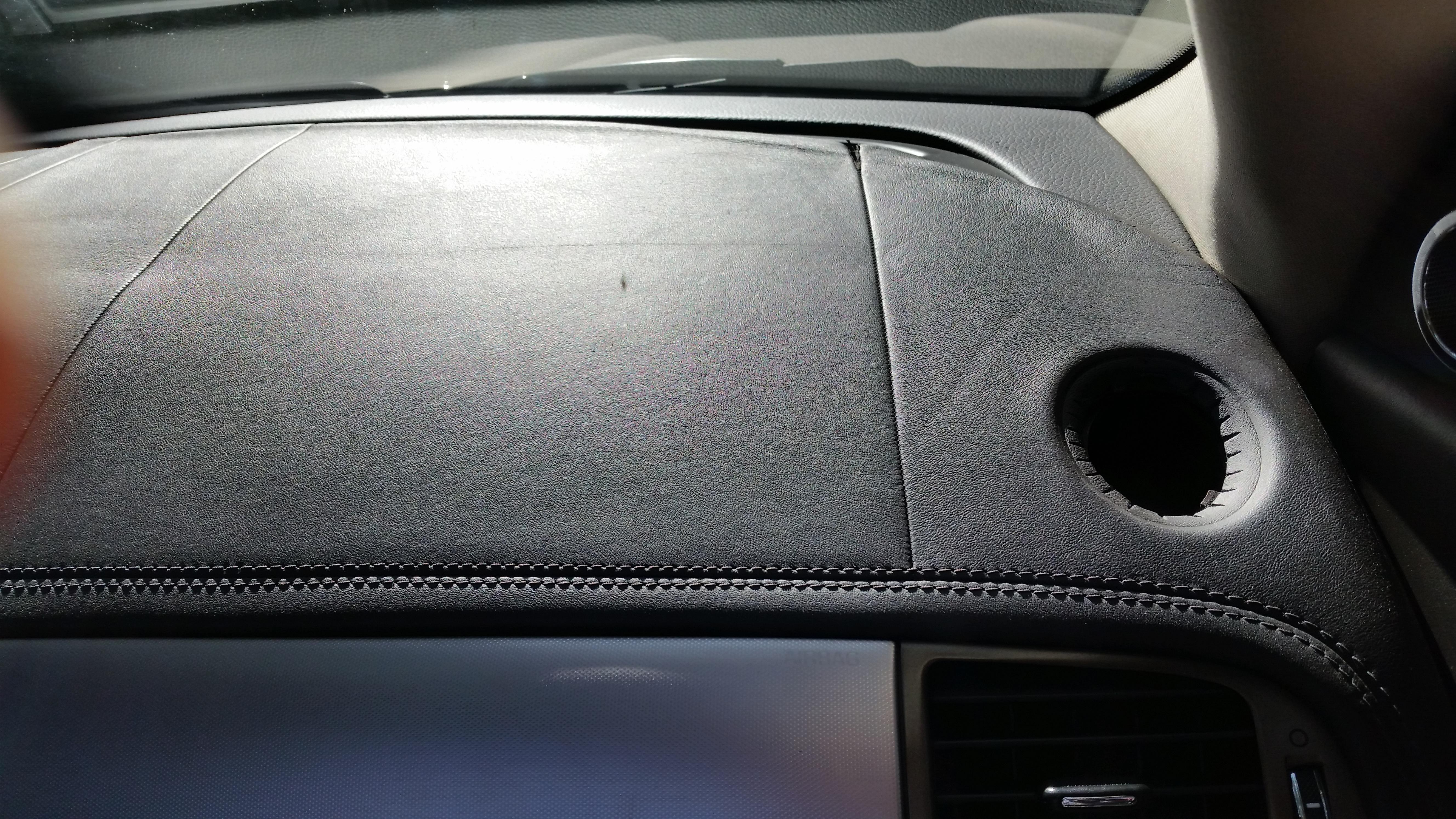

Default Side window defroster vent cover
Did you find a solution? I have an 09 XK and lost the passenger side defroster vent cover and am having the same problems as you finding a replacement part.
I do believe the discussion is about the long vents between the dash and the windshield to defrost the windshield, and not the round mid-vents.

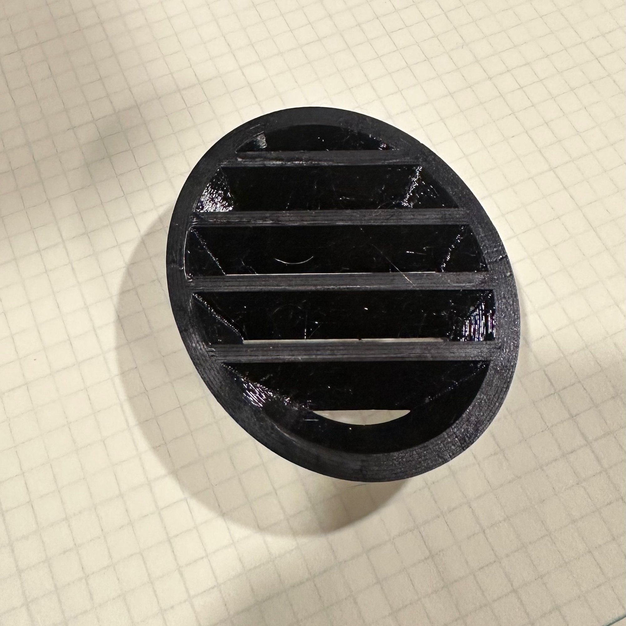

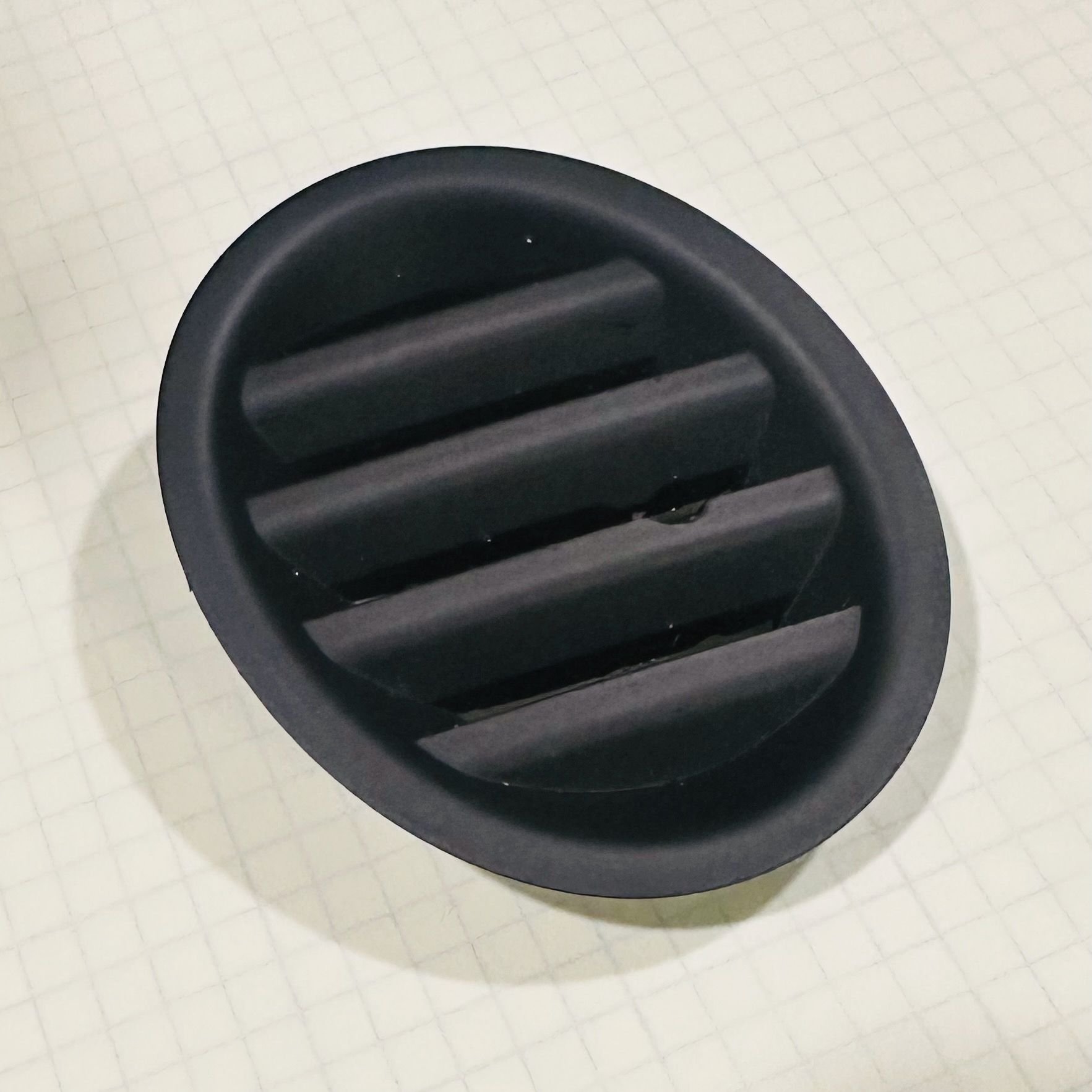

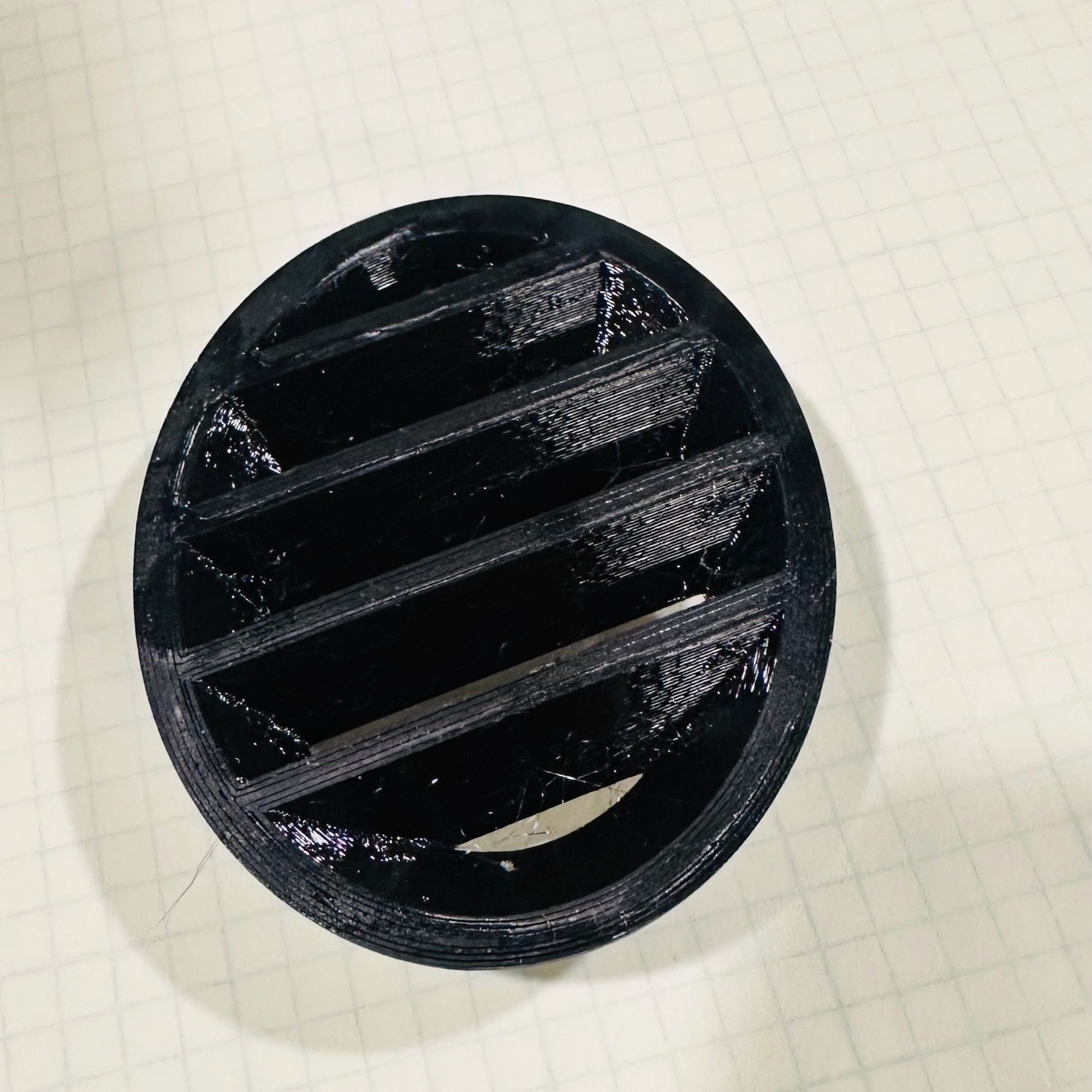

Default If you have a 3D printer
Hi
For anybody that has a 3D printer or has friend with one I have just uploaded the 3D models for the left and right dash vents for my 2009 XK.
The left vent only XK popped fell to the floor after I was careless pulling the sun shield from behind the steering wheel.
Pictures ae attached of the first prints which are in PETG and too shiny so I will be reprinting in ABSwhen I get a chance,
Thee are not exact reporidctions of the original as the vanes are flush to the same level as the brim whereas the originals are slightly recessed. This was necessary to make it simpler to 3D print, nd hardly noticeable. Should be less that $5 material.
The files can be found at https://www.thingiverse.com/thing:6932107

The original Left vent cover
Replacement Left Vent Cover
Replacement left eat cover rear
Replacement Right Vent Cover
