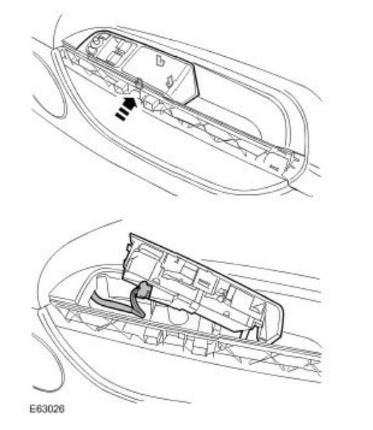

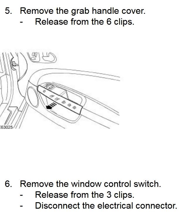

this may help

The tech manual 86.25.08 says to remove the grab handle cover but the cover is impossible to remove. Another respondent made the same comment in this thread.

Read the entire post... there are no screws to remove to remove the switch. Yes, those clips are tight.

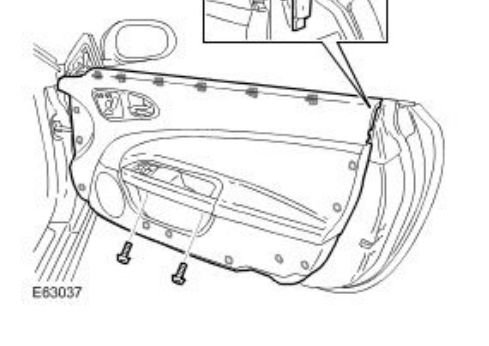

Grab handle screws - not sure if this gets you nearer to your quest:

When Jag says release the clips they never mention you might need a tire lever to do so. Some of those clips bite hard - great for quick assembly in the factory but a bitch when service is needed.
